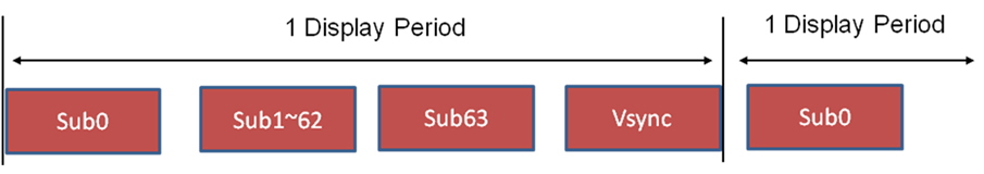

    In the application note, tlc5958 is described working in 8+8 mode. Actually tlc5958 can also be working in 8+6 mode.
    tlc5958 can support 8+6 mode, that means you can send 64 sub-period then follow up with a Vsync command, it will enter next frame rate display.
    You don’t need to finish all the 256 sub period. Timing is below. Be noticed that, you still need sending 16bit GS data while working in 14bit mode.

  • Hi Tokumoto-san,
    For your 1st question, if tlc5958 works in 8+6 mode.
    You need to set below for GS data.
    Still send 16bit data with 2 LSB 2b'00 and high 14bit represent the real GS data.
    For example: GS=4h0004, then the brightness ratio will be 1/16383.
                             GS=4h0008, then the brightness ratio will be 2/16383.
                             GS=4hFFFC, then the brightness ratio will be 16383/16383.
    For your 2nd quesiton, the calculation is correct.
    If you want to realise 14bit GS in 33M and 1/32 multiplexing and 60Hz, you can reduce dead time.
    Or you may want to realise 13.8bit GS.
    Feifei
