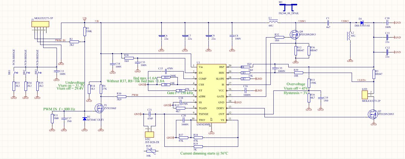

I try to configure the hysteresis for the under voltage on the nDIM pin (6).
It works correctly only with PWM @ 100%. As soon as I dim the LED the hysteresis as no effect
Can anybody help me?
