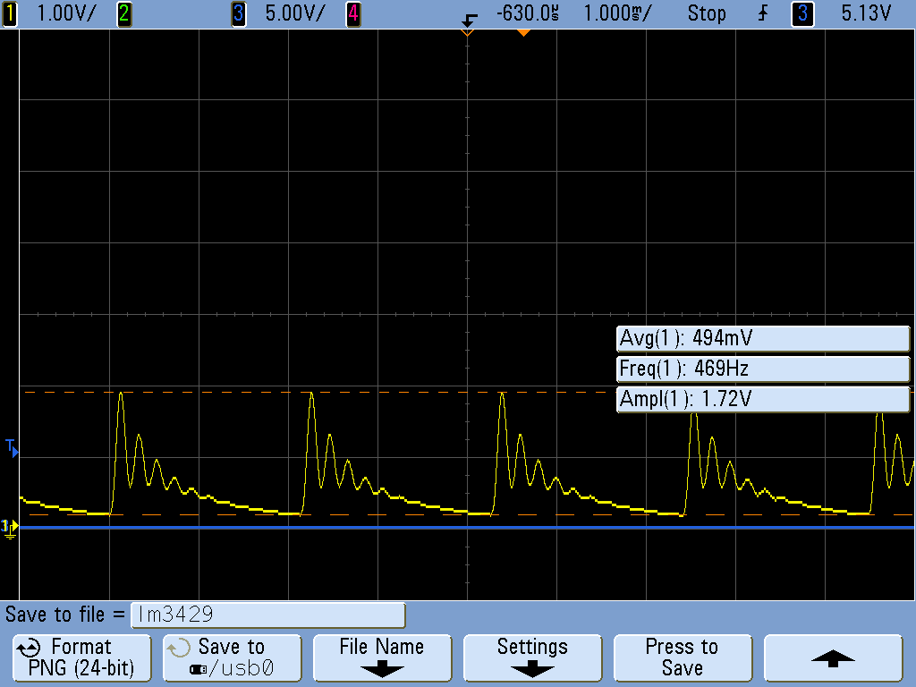

  • Hi Clinton, I've tested the proposed circuit, we have now a CM of almost 6 volts which is much above of minimum common mode needed. We still have the same behavior as before so the problem shouldn't be related with CM at these pins (at least for proposed values), it seems to be a problem concerning the control at low currents or maybe CM at the input should be much higher (as figure 5 of datasheet shown for Vo 20V) or maybe this analog dimming figure is for another topology (not SEPIC). Find attached some screenshots taken during test for different output voltages (load is a 27 Ohm resistor), this is for output voltages lower than 5 V, from this value the output signal is very stable and clean:
    Could you confirm us the full range analog dimming using this topology or for another CM? Both input and output are well filtered by two Pi filters (Without them the noise is very noticeable), PCB segregation is fine and EMI bypass caps have been placed, the IC layout is also OK.

  • I have not used this device in sepic configuration myself, but there are some things to consider that I do not see in design #8. First, it doesn't look like that design was specific for analog dimming. It can be done of course, but as mentioned, you may need to increase the COMP capacitor 4x to analog dim well due to the change in stability over the current range. Second, I see this design does not specify a coupled inductor. That is always the best way to go for a sepic, something like the MSD type inductors from Coilcraft. This is not absolutely necessary and two inductors are fine, but you almost always need a snubber across the sepic cap with two inductors to get rid of the ringing. You will likely need to put an RC across it with the cap 3x the value of the sepic cap and then tune the R for your application to get rid of the ringing.
    All that being said, the full range for dimming really is app specific for the most part as you will eventually run into a minimum ON time situation so the amount of energy transferred to the output will depend on component values (Ls and Cs mostly) and you also have some amplifier offset that will limit the minimum sense voltage.
