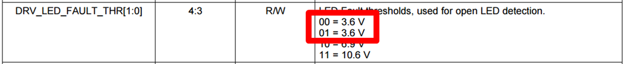

Hello Team,
I’d like to ask you about LED short detection threshold for LP8860Q1.
I checked both DRV_LED_FAULT_THR[1:0] = “00” and “01” are 3.6V.
Could you tell me these rating difference?

Hello Matsunami-san
There is no difference between these two settings.
