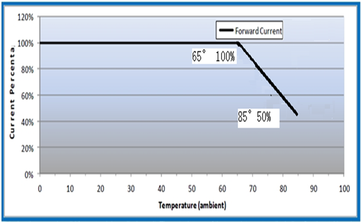

    I have another question about the External NTC Sensor. When I use the LED Current Dimming with External NTC Sensor to get the dimming curve as attachedment show, how to calculate R1 and R2 on page 37, figure 34?
