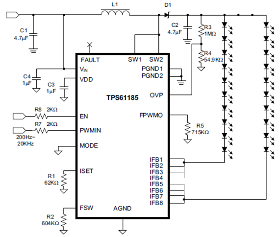

My customer has question about TPS61185.
Could you tell me about questoin?
[Question]
 Is there thermal data in close to under the following condition?
 - Condition -
 Vin=6V, 11V, 21V
 LED=9S8P
 Iled=20mA/ch
 fsw=1.25MHz
 L=4.7uH
 Ta=25degreeC
 My customer wants package rise temperature is less than 22 degreeC.
 They wants reference data.
tateo
  • Hi, my customer has more questions.
    Could you help us?
    - When Rfsw is set 475k(fsw=1.26MHz), how much is the variation of the switching frequency?
      My customer wants to avoid the frequency is between 1.62MHz to 1.98MHz.
    - Can the device be set two strings configuration?
    tateo
  • Hi, I am afraid we don't have the thermal data for this specific operation condition. cause the final thermal number depends on many variables ( PCB layout, power loss, thermal design etc). the only thermal reference we can provide is the thermal parameter table in datasheet.
