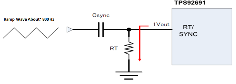

I want to achieve the Spread Spectrum in the ingenuity of the RT / SYNC pin of this device .
Is it possible to be realized ?
(Configuration example will be described below)

  • Yes, you can achieve spread spectrum that way provided it is a ramp wave as shown and not a sawtooth (a fast edge could trigger the sync function). You can also achieve the same thing without the capacitor if you connect the resistor to a ramp wave rather than ground provided the ramp wave trough is ground and the peak is < the 1V w.r.t. ground regulated voltage of RT.

    Can you tell me about the following points, again?
    ・Can the Fsw follow smoothly by the Ramp voltage (80Hz) ?
    ・Recognition Is that CLK synchronized 80Hz If you enter a sawtooth wave ?
    (if the answer is "YES" there is a shift in the recognition of each other .)
    Pokkun
  • A ramp voltage will work and the switching frequency should vary along with it spreading the spectrum.
    A sawtooth with a sharp edge would give you an extra switching cycle at each sharp edge.
    Us a ramp, not a sawtooth for spreading the spectrum.
