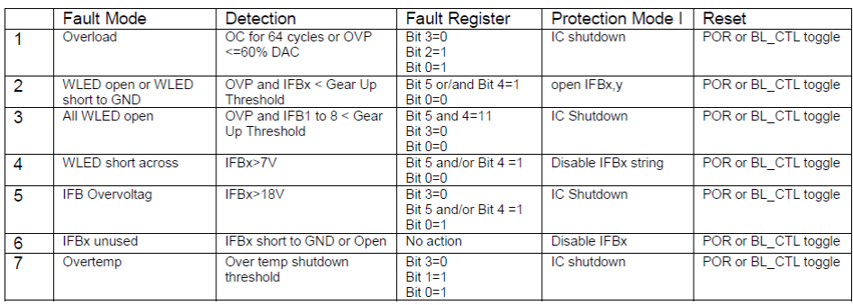

    We have a table to summarize the fault states - not sure if it was an early TI table or customer generated (I can't seem to find this in our documentation).  Given your information above, this would seem correct - but please review and confirm/correct:
    It would seem like the fault logic is like this:
    If bit 3=0 and bit 0=1 then there is a real fault (regardless of other bits).
    If bit 5 or bit 4=1 then there is also a real fault (LED open or short)
    Dan
  • Hi Dan,
    Yes, correct.
    However I'm not sure specific conditions of fault detection in the table is still valid or not - we may need to ask IC design team.
    Milo
