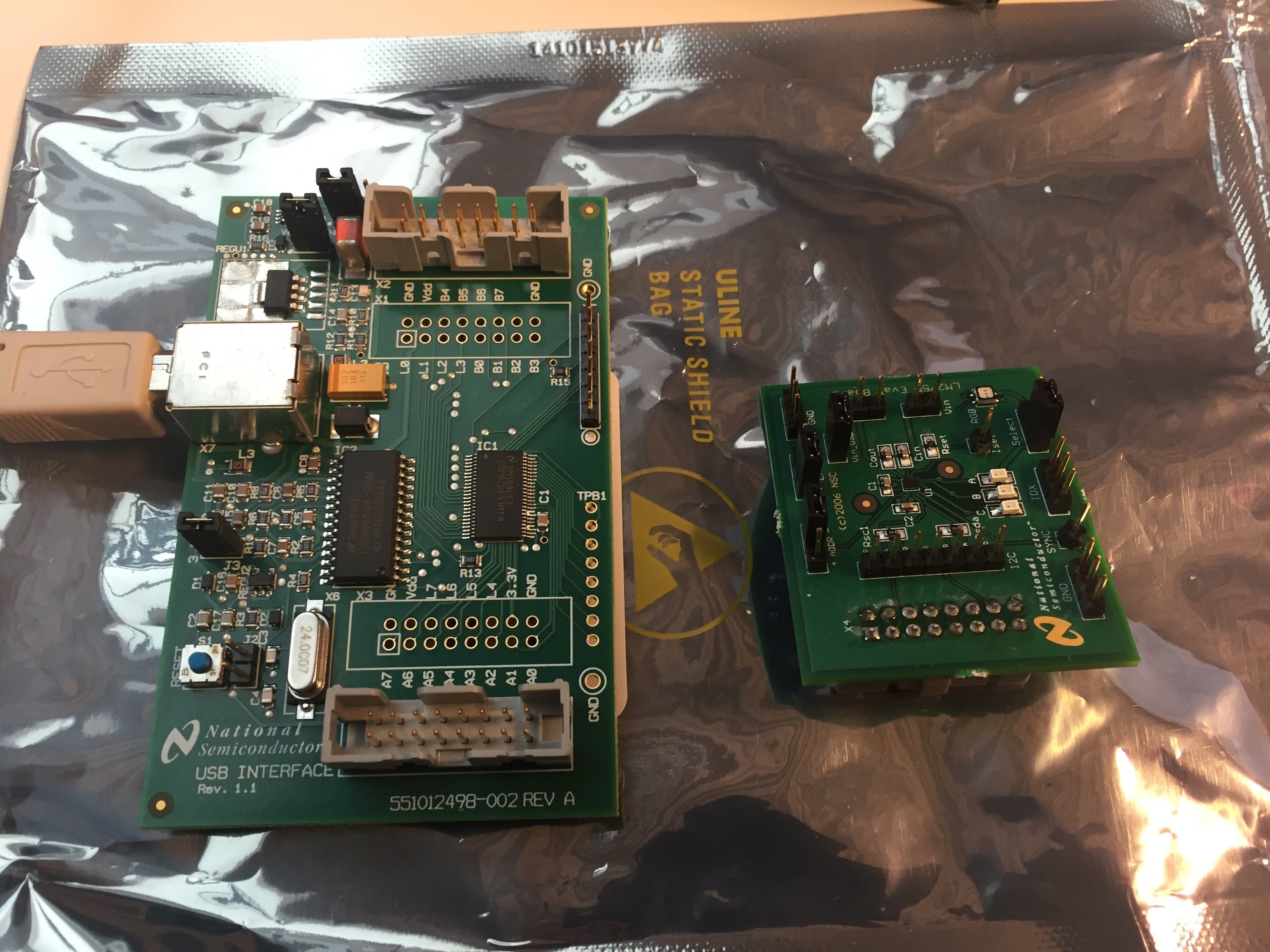

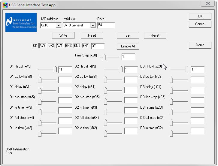

my cst is evaluating our LM2755. They received the EVM but the USB connection does not work.
Following message occurs : USB Initialization, error.
They are using for USB connection the board from National delivered with the evaluation kit, see attachment.
How to solve the problem.

  • Unfortunately that USB interface board no longer works with Windows.  I can send you a work around.  is your contact Maier Olrik?  I will send you the info through email.
    Travis

  • Some additional info in case it helps others.
    The baseboard I got with the LM2755 evaluation board is labelled:
    National Semiconductor
    USB Interface
    Rev. 1.1.
    551012498-002 REV A
    which is also what you can see in the photo from Olrik.
    Travis told me this is the board that has problems with Windows 7 etc. His workaround involves using a different board, ANY2USB.
    However, it's not completely impossible to get the National Semiconductor board working with Windows 7.
    My first attempt was on a Windows 10 laptop, where it didn't work. I then tried on my laptop with Windows 7, where it also didn't work.
    But on the third attempt on an another (and old) Windows 7 laptop it did work.
    Observations:
    On the first two machines, where it didn't work, Windows managed to find/download USB drivers from Windows Update.
    On the third machine, where it worked, the driver installation took a very long time and eventually _failed_ to find/download drivers from Windows Update. I don't know what (local) drivers Windows used instead, but they allowed the USB connection work just fine.
    So a possible workaround (untested) could be to disconnect internet before plugging in the USB cable, so that the driver from Windows Update can't be used/found.
