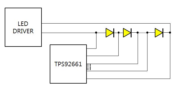

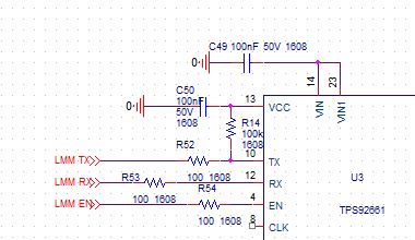

I design the 9 LEDs Matrix circuit, so I use the 1 TPS92661-Q1 chip as below.
I have a question about how to design CLK pin using external oscillator(not microcontroller unit, e.g. crystal).
I think oscillator need the 2pins but TPS92661-Q1 has just 1 CLK pin.
and Please check if the Tx pin design is correct.
Thanks.
  • Hello Sora,
    Regading your oscillator question. There are a number of oscillators available that an simple single output pin devices such as these from digikey:www.digikey.com/.../172
    The devices that need two pins like X1/X2 are bare crystal oscillators.
    The pull up on your TX line looks good. The question I have is about R52. Is the LMM_TX net a very long net that could have other voltages couple in and damage the TX pin? Unless this wild fluctuation is a strong concern I am not sure if the inline 100ohm resistor is needed on the TX, RX, or EN lines.

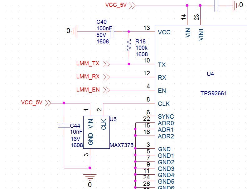

    I redesign the circuit below and use the oscillator you recommended. Is it OK?
    Also, I have a question about register. I just control the LED ON/OFF except for LED Dimming. How do i control the register map? If you can, Please example of source code.
  • Hi Sora,
    The MAX7375 has +/-4% initial accuracy at 25C/5V.  This is not accurate enough for asynchronous communications.  You need to maintain +/-2% accuracy.  A part I have used in the past that easily meets this is SiT2024.  You can power that directly from the VCC pin of the TPS92661.  It is automotive rated and not that much more expensive than quartz.
    You have to manipulate LEDON, LEDOFF, ENON, and ENOFF to manipulate the LEDs through the fully range of duty cycles and to allow phase shifting.  What do you mean by "control the register map"?

    I have two question.
    First, If LED Driver IC supply 600mA, Is it right  that LED input current is 600mA ?
    I saw the datasheet about  TPS92661 output current range. What does it mean?
    1) TPS92661 can supply max 2A. So, LED input current is "LED Driver IC supply current + TPS92661 supply current"
    2) TPS92661 can control max 2A. So, if LED Driver IC supply over 2A, TPS92661 doesn't work..
    Last, Is it correct ?
