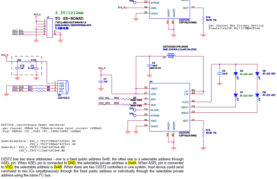

May I know TI have I2C two slave address Dual Boost LED Driver? we find some parts only have one address such as LM3643 (63h)
Current we survey OZ572 to design our IR LED. Thanks.
