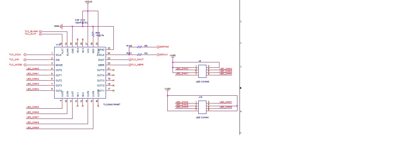

I hanve tested TLC59401 in my design. I met some problem when OUTX set from H to L ,and OUTX is L , VLED is also dropped low, I think there is some incorrect in my sch,So pls check it for me,

Thank you for your reply! I am the tester and who is facing the problem and the VLED schematic is shown below:
The problem is that when OUTx is ON, it will drop to nearly 0V at first,and then rise to a normal ON level(the normal ON level depands on the LED number in a strip and the VLED value).so at the OUTx-0V time,the VLED is dropped too.According to my test,the problem disappears when I decrease the OUTx current, but the max current I have set is no more than 40mA/OUTx ever and the datasheet shows that I can get 120mA MAX current per OUTx. So I am confused,is there something wrong ?
C15 should be 100.0 uF (tantalum LOW ESR) in parallel with 1.0 ceramic capacitor, trace current loop SW->D2->C15->GND should be as short as possible. Also C14 you can remove it for faster feedback
