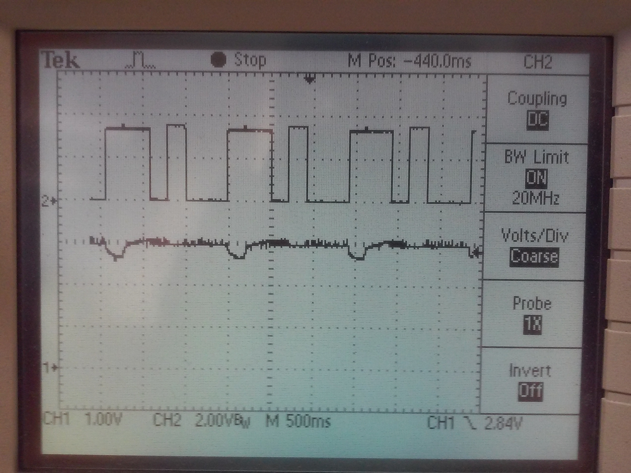

    Supercapacitor SCCR16B205SRB, for output cap I have only description: 2,2 uF 1206 10% 16V X7R
    Here CH2 is EOC pin, CH1 is supercap voltage.
  • It is interesting that there appears to be something loading the cap.  I am assuming the larger dips are flash pulses?  I am curious as to what the secondary drop is from.  Do you have other loads on the cap?  Additionally, it is odd that the EOC voltage is moving.  Is there some sort of loading?  The change in EOC voltage is synchronized with the recovery of the supercap.
    What is the pulse width of your flashing?  Freq?
    Greg
  • Also, I am assuming you have two supercaps in series as the caps look to only be rated to 2.7V each. Please confirm. If this is the case that is a good amount of ESR which could be causing the EOC to transition.
  • In the first time on the photo EOC is Low and I send command Flash, Supercap start discharging and at once, EOC going High, flash time is 192ms (but I use fixed delay of 200ms) after that I start Optimal Charging as had been in previous cycle, after some time EOC is Low, but I send new commant to Flash after fixed delay of 500ms, thus some amount of time we see EOC Low,
    then I again send command Flash, but with Gating, as usually EOC go High at once, Flash does not occur, and after fixed delay of 200ms I start Optimal Charging again, EOC goes Low at once, because Supercap not been discharged, after fixed delay of 500ms that cycle continues.
    Supercap do not have any other loads. I use 2 supercap in series.
