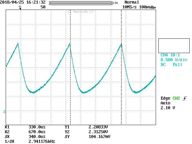

 One of our customers is evaluating TPS92641 using their own PCB for light source application of their new products. They refer to PMP8016 schematic and layout. Their parts parameters are almost same as PMP8016.
 PMP8016(Single LED with High Current 20A Application using TPS92641)
http://www.ti.com/tool/PMP8016
 Also their input voltage is 12V, output current for LED is 20A, LED color is green and the LED Vf is about 3.2V. The number of LED in series is one.
 And they are controlling SDIM input signal for LED turning on/off not UDIM because they need high speed LED on/off control.
 They found un-stabled voltage waveform on COMP terminal as the attached one when SDIM = L level (LED is in off state).
 Could you please take a look the attached waveform and please give me your idea what the reason of the COMP votage waveform is?
 Also could you please give me your answer for the following questions?
1. According to the function block diagram on page 10 of TPS92641, a switch controlled by PWM_DIM signal is inserted between EA and COMP terminal.
   Is the switch open when SDIM=L? Or is the switch on/off not controlled by SDIM signal?  Is the switch always on not depends on SDIM H/L level?
2. If the switch is open (COMP is floating) when SDIM=L, is it effective to insert a high value resistor (ex.1Mohm) between COMP-GND for votage stabling and lower voltage keeping?
3. Can we buy or borrow PMP8016 board from TI?
4. Do you have any voltage waveform of switching node, COMP terminal, HG,LG and inductore current when SDIM=L level?
 Your reply would be much appreciated.
 Kazuya Nakai.
  • Hello Kazuya,
    What PWM frequency are you using on SDIM? I would expect COMP to change some between the two states but not likely that much. However, 2.2nF is a pretty low value and possibly used so that current can slew fast with changes in IADJ. If you do not need that you might be better off increasing COMP to 0.1uF and see if the oscillation goes away. I am not sure how this design was tested initially. But to answer your questions:
    1. COMP is only disconnected when using UDIM. SDIM will keep it connected as you are still regulating output/inductor current while the shunt FET is on.
    2. It stays connected, but I would try a higher cap value as I said above.
    3. I don't think any are available at this point. But gerbers are provided so it should be easy enough to fabricate your own.
    4. I don't have any waveforms unfortunately. But as mentioned in the datasheet the inductor/output current is still regulated. The switch node will show minimum on time pulses with the off time adjusting so that current is still regulated. That would be reflected in HG and LG.
    Clint
