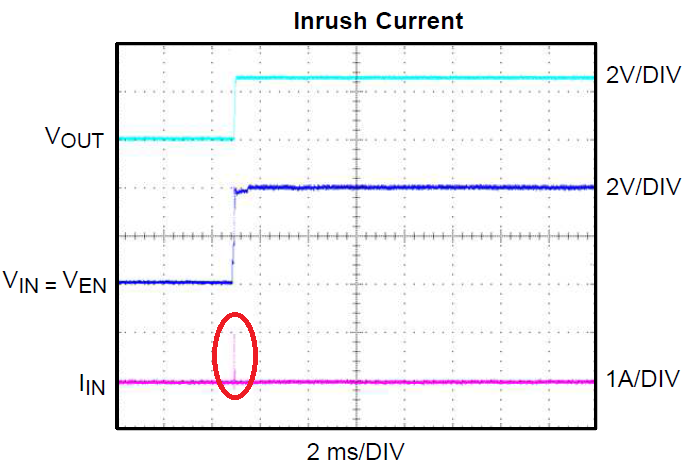

They would like to decrease the inrush current of the Figure5(Setup timing of VIN and VEN is simultaneous).
If a startup timing of VEN is different from VIN, does the inrush current decrease?
If no, could you please let us know if you have any advice?

    A2 : The in-rush current depends on the internal start-up (i.e. rise-time) of the reference voltage circuitry via the EN pin, the Cout value, and the internal current limit. There is no good work-around.

    [Q2]
    Thank you for the information!
    I understood that the inrush current does not depend on the input voltage.
