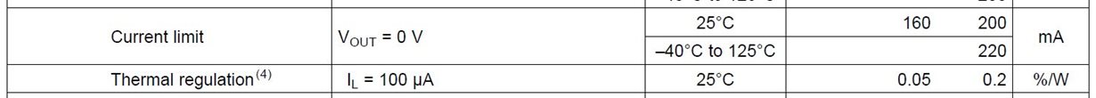

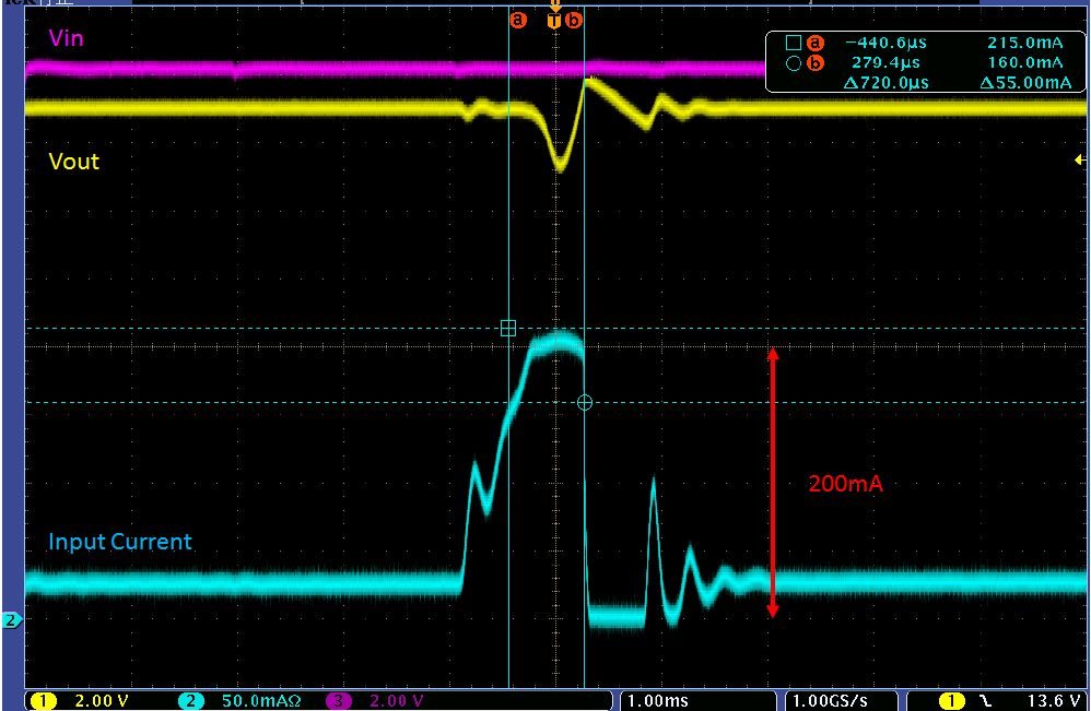

Our customer is evaluating LP2951 with large pulse load like attached. Then they are asking if there is possibility of damage by such load current over current limit. I think it'll not be damaged unless over heating because the load current will be limited by current limit function. Is my understanding correct?
