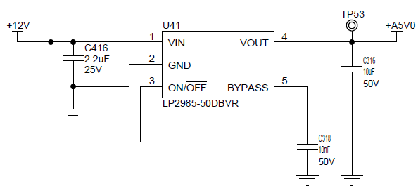

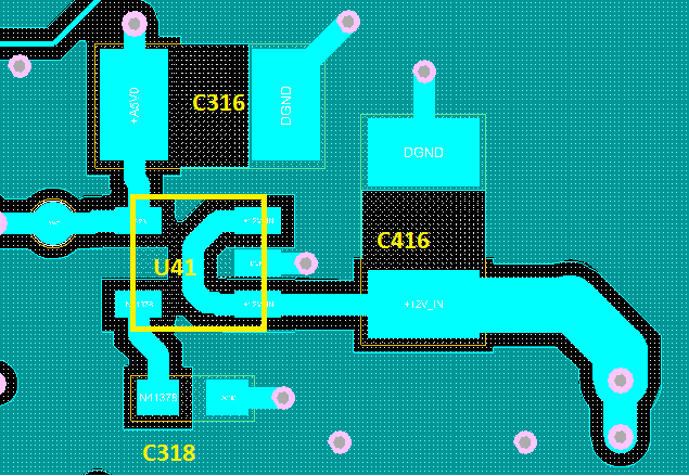

I am attempting to use the LP2985 for a 5V analog supply. However, when I apply the 12V input voltage, the output sits at 1.25V and is stable. (internal reference voltage perhaps?). The load should be less than 100mA. however I have not tried disconnecting the load yet.
The capacitors are X7R ceramic. I realize their ESR is probably too low.
When I removed C316 and any immediate downstream capacitors, the problem persisted however this time the voltage ramped to 1.25V slower.
I also replaced C316 with a 10uF tantalum cap and the behavior is the same.
I replaced the LP2985 with a new device and the behavior was the same. Layout is not exactly per the datasheet but the parts are reasonably close.
Any suggestions?
