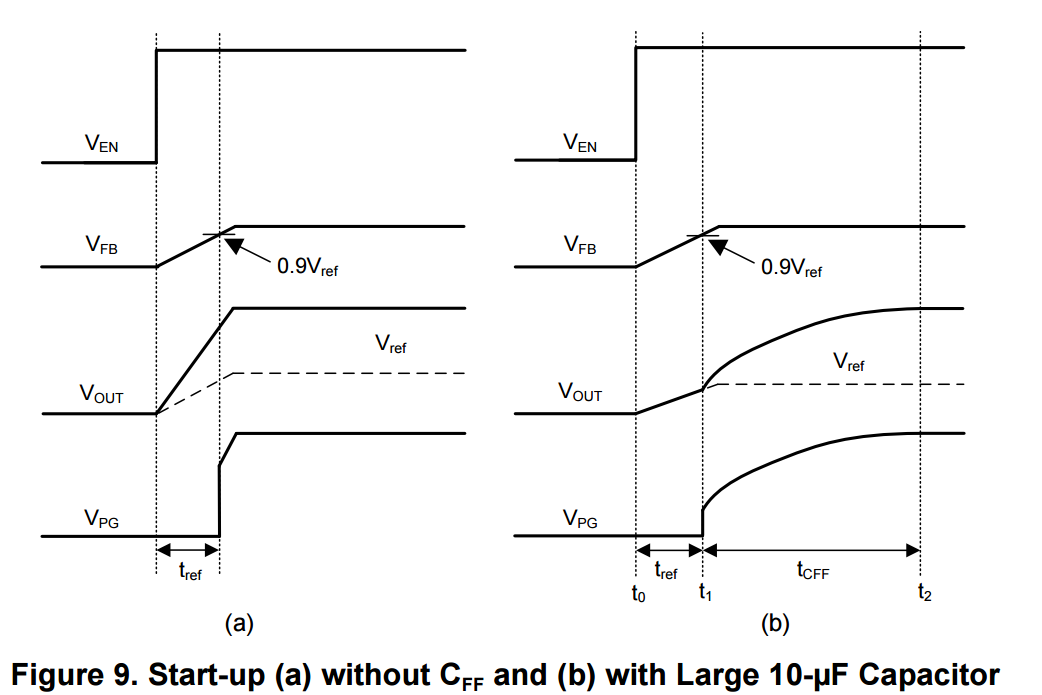

The datasheet of tps7a8300 says the power good function is not valid when feed forvard capacitor is used.
However in the evaluation module, both feedforward capacitor used and power good function is used.
What does the datasheet mean by "valid"? I need power good signal in right time for power sequencing with system fpga.
