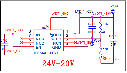

My customer use below schematic.

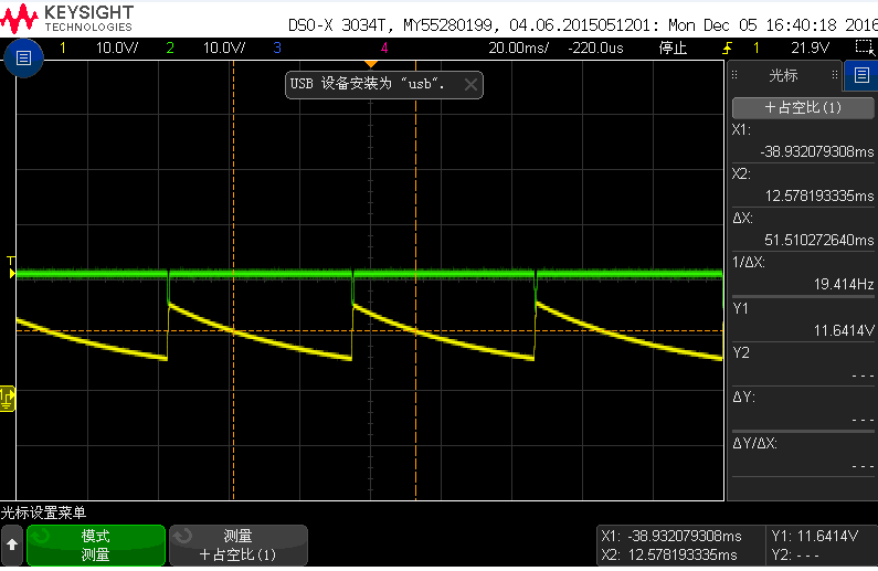

And they find when they increase the load. The output will be like below:
Do you have any idea why it will cause this issue?
And we find if we repalce the chip with TPS79850 (pin to pin part), it will be OK. So need your help to analysis the difference.
