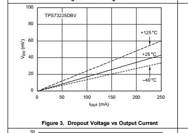

    The Electrical Characteristic specification covers the entire family of devices.  Temperature accounts for the majority of the delta.  Please see Figure 3 of the datasheet (copied below for your convenience).  The dropout for the 3V output will be similar to the dropout of the 2.5V output over temperature.

    Actually, customer and I were able to find fig3 on datasheet but it doesn't not answer the question.
    If I read the figure you've copied, Vdo=60mV @ 250mA & 125degC but the max value in datasheet page6 §6.5 is Vdo=150mV.

    We do not share this type of information over the forums. We encourage customers to design to the specified worst case conditions in the electrical characteristics table and provide typcial characteristic curves to show how other factors such as current and temperature affect a given attribute.
