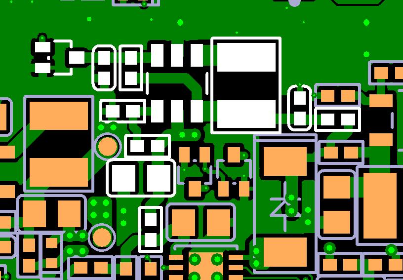

    About the over voltage stress to damage SW pin, the chip is mounted in PCB with another circuit.
    And it haven't any connect to let us direct access.
    In board level, we have Li-iron battery(3V-4.2V) only and only this chip has boostor function.
    Base on data sheet the max. level is 7V.
    I don't know why & how the over voltage stress to damage SW pin.
    Please find circuit(attached before) & layout.
    Lewis

    the output capacitor in your PCB is too far away from IC. so  i suspect that the voltage spike in your application is much higher than 7V. please place the capacitor as closed to the IC as possible. you can find PCB layout reference for this device in http://www.ti.com/lit/ug/slvu106/slvu106.pdf and page 16.

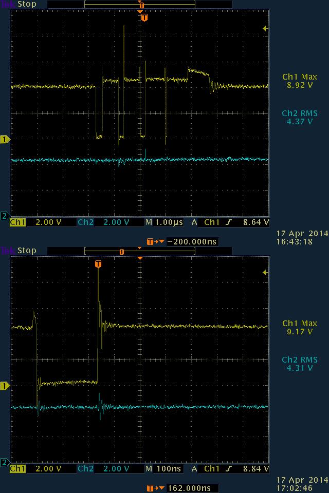

    And I try adding capacitor(220pF ~ 47000pF) between SW to GND. But the spike level no any change(still higher than 7V)
    BTW, please check with attached picture, there have some abnormal waveform in behind of switching signal.
    Please let me know your comment.
    BR
    Lewis

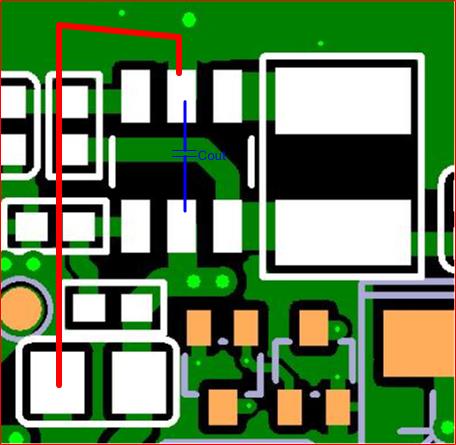

    the reason is that the track from IC GND to output capacitor GND is too long, as the red line. please try to place the ouput capacitor above the IC as shown below to double confirm the problem.
    if this work, you can then consider to modify you PCB. you don't need to add snubber if doing good layout. and actually it is very hard to design good snubber, and most of time subber circuit will cause other problem.
