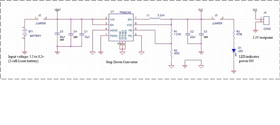

  • Hi Michael,
    Thank you for your reply.
    We haven't received our power board yet, we are suppose to receive the same in next 2-3 days. I wanted to understand the problem faced and precautions taken to resolve the issues mentioned earlier in the thread.
    Please find below our schematics. To save the IC from overshooting voltage I have put an ESD diode in place. Can you please review the schematics and give your feedback. TPS62160 looks good.
  • The input esd diode should help with any input voltage transient spikes.  Please measure Vin at the IC on your board to confirm you do not have a problem.  Be sure to exactly follow the EVM layout to minimize the possibility that you have a layout problem.  Input cap is most important component.  I did not review your component selection; I assume you followed the datasheet recommendations when selecting them.

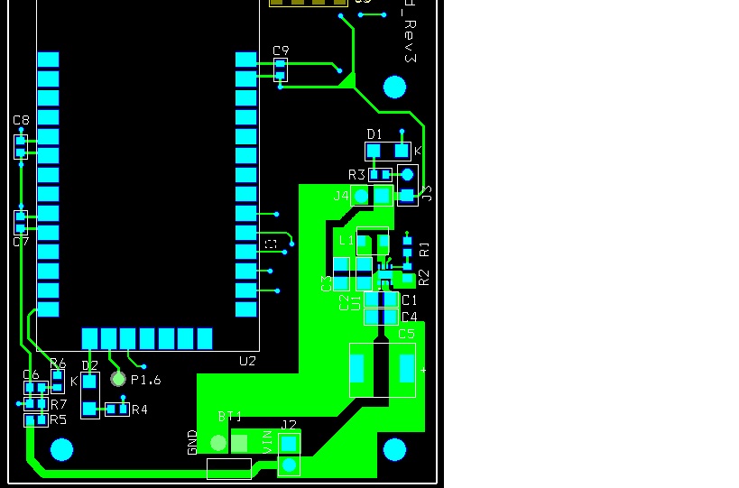

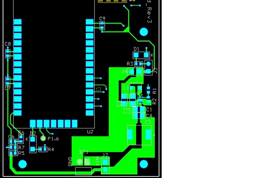

  • Hi Michael,
    We did our design for the power board using TPS62160. I followed the schematics and layout recommendation as provided in the evm. I am facing a very strange issue. The output voltage of my board is not stable, it is continuously varying from 3.2 to 5v at no load. The voltage at FB is also varying.
    As soon as I connect the load (LED) at output, output voltage stabilizes a bit and varies between 3.9v and 4v. It should ideally be 3.3v.
    Please find below schematics and layout of my board.
    What can be the possible issue? Please help me out.
    Thanks and Regards,
    Aziz Jiwani
  • I do not know the other customer's final resolution. They did not reply with what they did to solve their problem.  I would like to recommend that you contact your local FAE in India.  They will be able to work directly with you understand the waveforms and help find the problem.  Without actually seeing scope pictures of the relevant waveforms, it is very difficult to know what is going on.  You local disty FAE should be able to go into the lab with you to help you with these measurements.
    I figured out the issue. I have made a mistake of connecting PG to GND.
    I tested the board again after cutting the track between PG and GND. Regulator is working fine (output: 3.3v) with PG floating.
