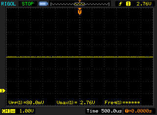

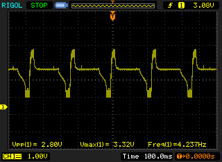

  • Could you provide the scope waveform of battery voltage, input votlage of TPS61260, output voltage of TPS61260, and load current(using current probe) if possible. thanks
    jasper li
  • Scope waveform of battery not connected to anything:
    Battery connected through fuses and diodes to the load:
    Input to TPS61261 with fuses and diodes and load:
    Output of TPS61261 with fuses and diodes and load:
    Input to TPS61261 without fuses and diodes but with load:
    Output of TPS61261 without fuses and diodes but with load:
    I do not have a current probe to provide u with the waveforms.
    P.S: I use TPS61261 EVM, not TPS61260.
    P.P.S: Detaching the Zigbee Modem makes the system work, as you suspected. But the TPS61261 can power up happily with the Zigbee modem and without the fuses and diodes. That does not make sense.
    Chris.
  • i think the problem is clear.
    1. when TPS61261 without fuses and diodes but with load
    the input voltage is 2.76V and stable, in the rang of operating voltage, so the device work well.
    2. when TPS61261 with fuses and diodes and load
    the input voltage of TPS61261 drop down to 0.5V periodically, out of the operating voltage, so the device stop working periodically. and the output voltage can't be stable at 3V to power your system.
    i think the problem is caused by high resistor of diode and fuser. you must make sure that the input voltage of TPS61261 is in the operating rang.
    by the way, your system seem to sink a high current every 200ms, not 1s as you said.
