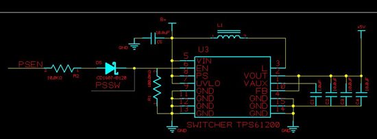

    The schematic is shown below. It is a TPS61202 (+5V Fixed) despite the generic part number. FB is tied straight to the output.
    Signal PSSW is normally tied to a momentary NO push button tied to B+ (Battery Voltage)  to turn the supply on until the processor supplied PSEN signal is asserted to keep the power supply on and turn it off under control of the processor.
    Even with R2 removed to isolate the processor and R1 reduced to 1K we still see voltage at VOUT. There are no switching waveforms when EN is low.  It simply appears as if there is a forward diode between pin L and pin VOUT.  With fresh AAA Alkaline batteries and 3V B+ we see about 2.2V at VOUT with EN low - even grounded. There is no advertised "load disconnect"  happening.
    When we do have R2 in circuit and assert PSSW with the push button the switcher does start up and we do get +5V. The processor asserts PSEN before the switch is released and the +5V stays on until PSEN is de-asserted and the switcher stops, but we still have voltage at VOUT.

  • hi Allen
    i do some experiment at the TPS61202EVM, and didn't find the problem as you describe.  but it seem there is a problem in your schematic. the resistor R1 is not connected to the EN pin, you can see there is not dot as in other connection. so the EN will be floating

  • Jasper,
    Actually the resistor is tied to EN. It doesn't show a dot in Pulsonix if the component pin is on the wire. It is tied to EN on the PCB.
