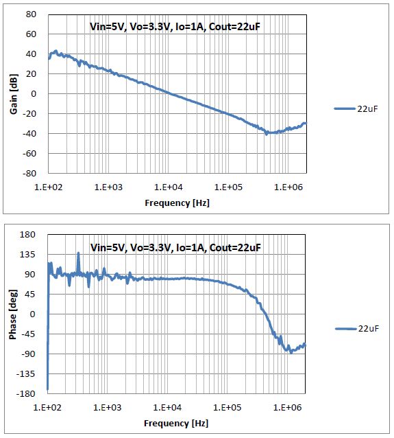

TPS62080 Gain Phase
I measured the phase margin at below condition on web EVM and showed the result as below.
Vin=5V,Vo=3.3V,Io=1A ,Cout=22uF    Rs=51ohm, Signal=3mVp-p
 Is the result correct? or is anything wrong?
