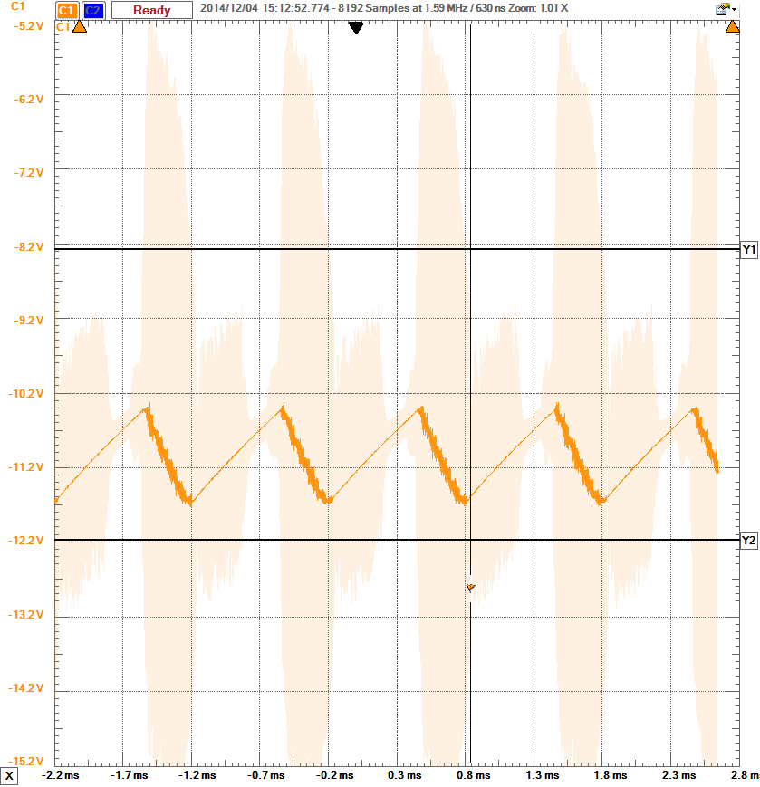

I am using a TPS5430 in inverting buck-boost configuration with enable logic level shifted with BJT controlled voltage dividers.
My application is Vin=15.7 V,  Vout= -11V  Iload= 40mA to 2A
I have significant high frequency noise on the PH node and Vout (which is unexpected since I have substantial low ESR filter capacitors), but the really strange behavior is a 1V, 1kHz triangular oscillation in the output voltage when powering a 5W resistive load.
More scope captures of this phenomenon are shown in the attached pdf.
I also included a schematic of my power supply circuit and screen captures of the PH node voltage and Vout high frequency noise.
All filter caps (330 uF and 10uF are aluminum electrolytic low ESR).
The compensation network values were computed using the procedure outlined in TI  app note SLVA237C
(http://www.ti.com/lit/an/slva237c/slva237c.pdf).
I have no idea why the large 1kHz oscillation in Vout occurs.  Any advice would be appreciated.
