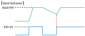

Hi Team,
Our customer would like to enable the device, when the output voltage is left.
So, we would like to know whether this device has "Pre bias".
If it doesn’t have this function, could you please let me know the recommended output discharge circuit?
[Back ground]
They need large load capacitor(Cload) for the load device.
Therefore, they have to enable the device, when the output voltage is left.
[conditions]
Vin=2.3V to 4.2V
Vout=6.0V
Iout=Around 570mA (peak current)
Cout=22uF
Cload=47uF*2 + 1uF*2 + 0.1uF*2=96.2uF
