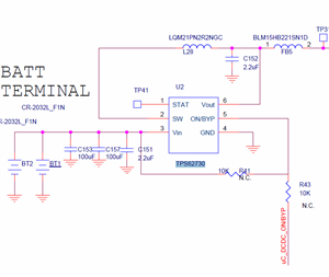

We are using TPS62730 & controlling it via the ON/BYP leg.

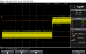

We have encountered a jump from 2.1 [V] to 2.3[V] while the leg is in active high state.
What can cause this?
Attached pictures from logic & hour design (R41 is not connected)
Please advice..
The schematics:
The jump:
