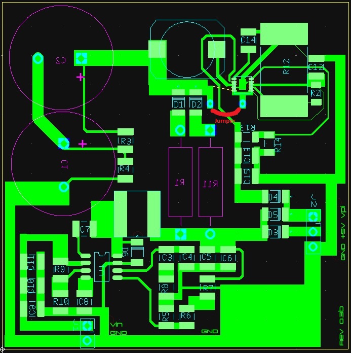

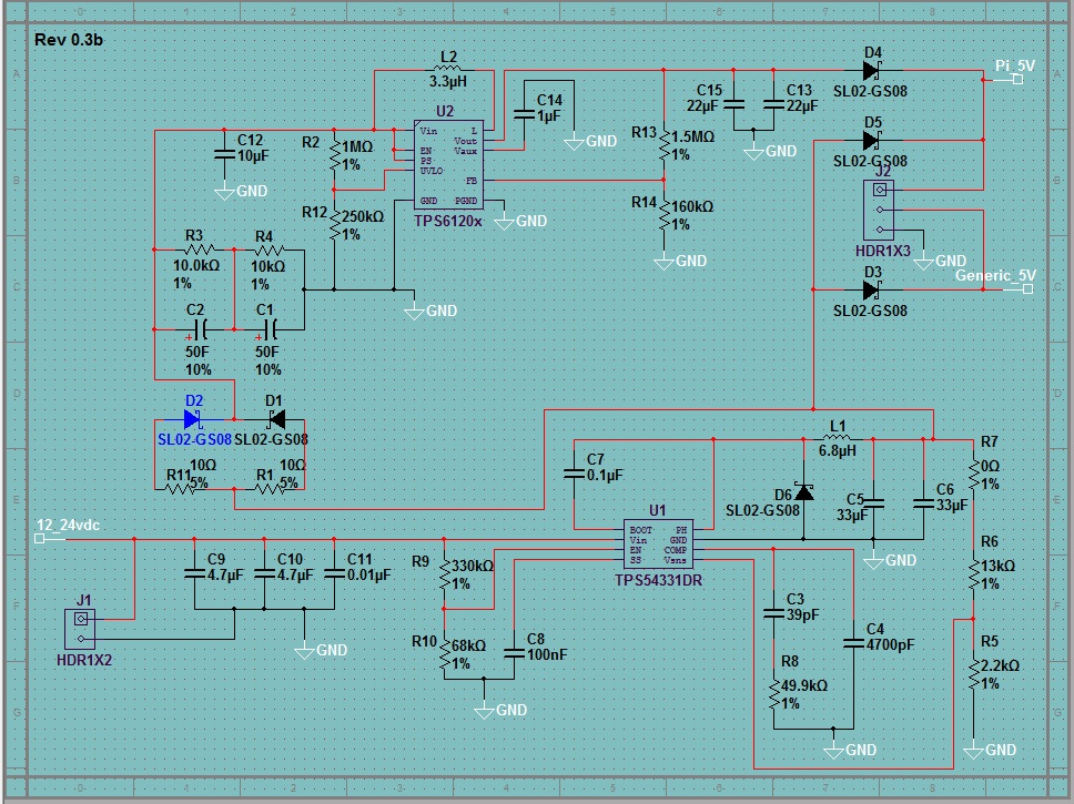

Here is the schematic and layout of the 5V circuit.

-Is so important the PCB layout (I haven't really cared for it in the handmade test PCBs) that may be the cause of my problems?

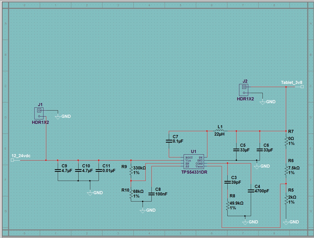

  • Can you post the rest of your schematic? Do you have any waveforms showing the improper operation?
  • Hi John,
    Thank you for your interest.

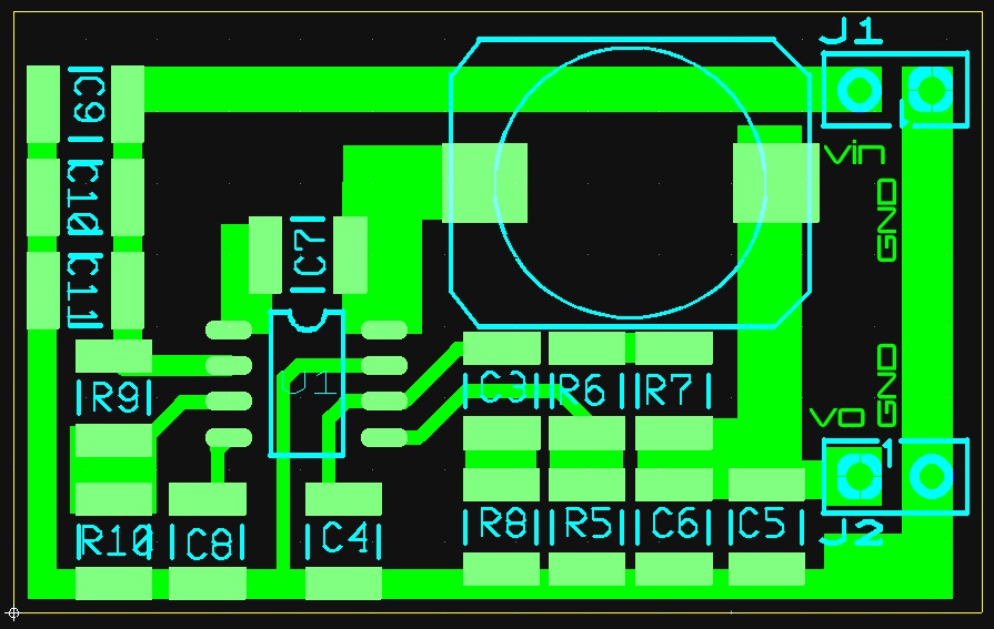

    Here is the rest of the schematic (the 3.8v step down) and layout. That test PCB works OK (after soldering a diode across PH and GND which I forgot when i designed it)

  • Where to start? I suppose first off we should talk about PCB layout. Yes, for dc/dc converters, layout is critical. I am not surprised you are having difficulty. You should look at the layout of the TPS54331 EVM shown here:
    www.ti.com/.../slvu247.pdf
    As you will see there is a lot of attention paid to proper grounding. Also the VIN capacitors must be located close to the IC and tightly coupled to the VIN and GND pins with wide etch fill areas.
    In the schematic I notice that compensation is the same for both. That is usually not the case.
    It will take a very long time to charge the super caps. i would suggest that you disconnect them and the other load circuitry. then get your two TPS54331 circuits fully debugged along with that other TPS61200 converter. then add in the super caps only. see how long it takes to charge them up fully. Is the 5V converter still working properly? You may see frequency fold back or other unusual behavior. Be sure to take waveforms. Once we get that up and running you can worry about other parts of your system.
