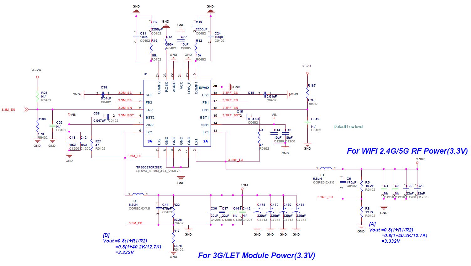

I have to test a TPS65270 based buck regulator design with Vin=12V and Vout=3.3V/3A. The 3.3V output power rail has 4x220uF bulk capacitance. I'm using C39= 0.1uF (and not 0.01uF) cap on the SS2 pin (16msec ramp-up time) to compensate the inrush current and the switching frequency is around 600kHz. I'm looking for the right values of a Type III compensation circuit as part of the DVT. However, when tried to use the equations on page_14 of the datasheet, I get very different figures comparing to the values used in the original schematic and in the application examples I had a look. I have no idea at the moment why the equations don't work for me. Nevertheless, any advice to find the optimum values for R16, C32, C31 and C44 is much appreciated.

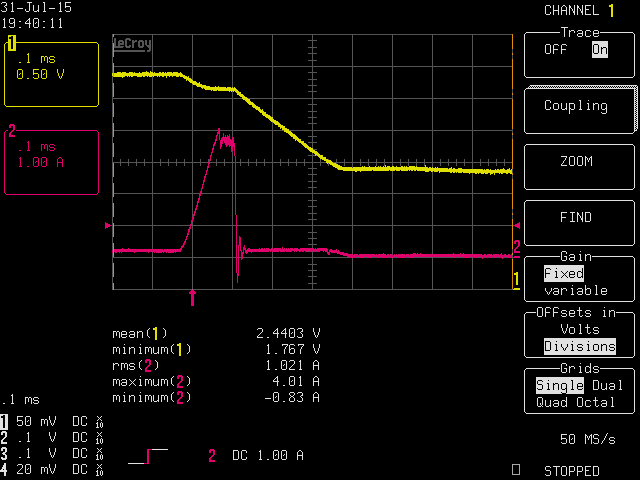

  • Hi Eric,
    I made the startup measurements with your suggested Cff = 82pF at C44 and with the maximum 5x220uF at the output and got the following ramp-up curve:
    CH1 (yellow): 3.3M_EN (pin#3 of U1)
    CH2 (red): inductor (output) current
    CH3 (blue): output voltage 3.3M
    This was done with a PCIe cellular module which didn't work with 1.6msec soft-start time (there was several stairs or plateaus but the output voltage was unable to reach the required 3.3V and remained at about 1.6V). By changing the the soft-start time to 16msec (C39=100nF) the problem dissappeared.
    There are two plateaus on the above curve, one for each current peak. The other modules I tried have just a single current peak during startup and there is a just a single plateau on that curves. Just please confirm that the above startup curve looks like as expected and there will be no startup stability issues. I'll run a long term startup stability test as well in the heat chamber.
    Thanks:
    Tom
  • Hi Ledeczi,
    the starting up waveform should be ok, please test more condition, such as power up with full load, transient response... to make sure IC works well.
    let me know if you meet any problem.
    thanks!

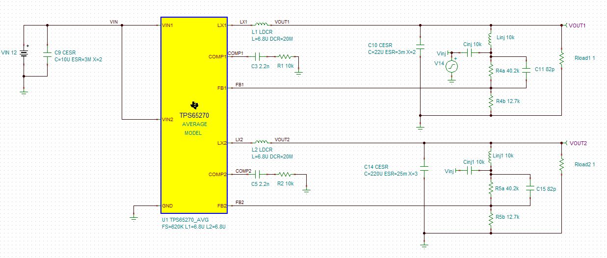

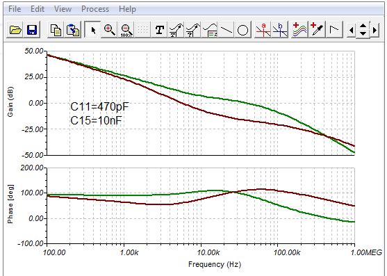

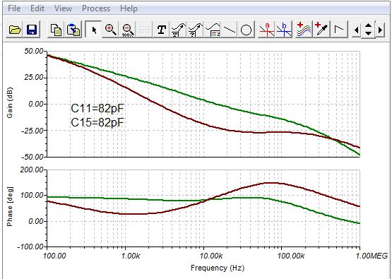

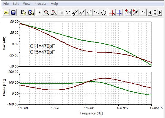

  • I played with TINA and used the "TPS65270 TINA-TI Average Reference Design" model with the passive values I have in the schematic.
    I run AC Analysis with different values of the feedforward capacitance. It was a long time ago I learnt control theory, but based on the simulation curves I think I have to go with Cff=2.2nF and not with 82pF (C44 in the original schematic, C15 in the simulation model). Increasing the value to 10nF decreased the phase margin, therefore the value of 10nF  for C44/C15 looks too much. I think the right value is 2.2nF and this matches with my time domain oscilloscope shots as well (see earlier).
    I played with the value of C11 of the simulation model (representing C6 in the schematic) as well, and see minor improvment going up from 82pF to 470pF as indicated in the schematics.
    The Amplitude/Phase curves are as follows (VOUT1=Green, VOUT2=Red):
    Based on the curves above, I'm planning to proceed with the following values:
    C11 (model) / C6 (schematic) = 470pF
    C15 (model) / C44 (schematic) = 2.2nF
    Please comment.
    Moreover, I would like to understand the theory behind how to select the right value for the feedforward capacitor. According to the datasheet: „Make sure that the zero frequency (Fzff) is smaller than soft start equivalent frequency”. In my case, with the 16msec soft-start time (C39=100nF) 1/Tss = 62.5Hz which means that Fzff=1/(2*PI*C44*R22) has to be less than 62.5Hz. With the recommended 82pF at C44, Fzff is around 48kHz which is far from the 62.5Hz value. I'm sure I missunderstand something, please advise.
  • Hi Ledeczi,
    we don't suggest to use such a big cff, please keep 470pF as the original design if the simulation is better than 82pF. after PCB is back, you can use frequency analysis instrument to optimze the parameters. simulation is not the exactly same as actual test.

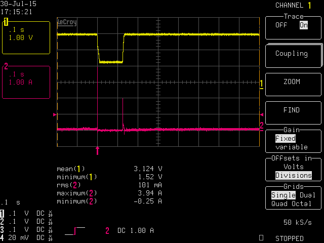

  • Hi Eric,
    Please have a look at the attached oscilloscope images. They both show the same event but with different time scale (100usec and 100msec). The event is a GSM module transient current which made the 3.3M cellular rail to collapse (RED: transient current of the attached GSM module, YELLOW: 3.3M supply rail).
    This is what I think about the issue. The TPS65270 regulator features a cycle-by-cycle over current protection. What happens is that the module’s transient current is over the protection current limit of the regulator, and the internal power MOSFET is immediately turned OFF and will be turned ON again at the next switching cycle. If the overcurrent condition still exists during four consecutive clock cycles (6.4usec) the regulator simply shuts down. This is exactly what happens in our case. After shutting down, the regulator waits for four soft-start cycles (about 64msec with C39=100nF) and starts to recover with a normal soft-start. If the overcurrent codition is over, the 3.3M rail ramps-up without problem. This is what you can see on the 0.1sec resolution scope image.
    Do you think my analysis is correct? Please advise.
    Thanks:
    Tom
  • Hi Tom,
    Sorry for the late response.
    you analysis is correct, why there has so large current at the transient output current? TPS65270 is 3A/2A buck converter.
    Add more cap at the output will be helpful for the big transient output current.
    let me know if you need any more hlep.
    thanks!
    Eric
