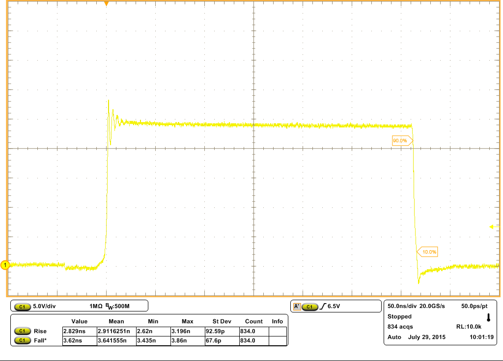

Would you mind if we ask LM43602?
How much is Tr(rising) and Tf(falling) time of HS-FET and LS-FET?
We could not find these.

Frank san,
Thank you for your reply.
Yes, our customer needs the rise and fall time on the SW(H-side and L-side) node.
Please refer to following our cutomer's conditions;
<Input voltage, output voltage and load>
-Input Voltae : 24V
-Output Voltage : 3.3V
-Iout max : 2A

Frank san,
Thank you for your very prompt reply and your cooperation!
We got it.
