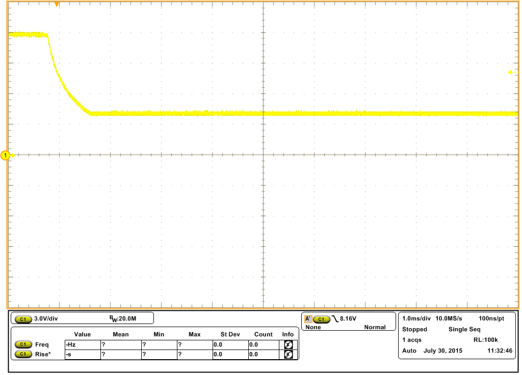

Could you please let me know the DCDC converter which has the following specifications.
Vin=3V~4.5V
Vout=15V
Iout=100mA
Output Discharge
OVP
I found that the TPS61093.
However this device output discharge is body diode and leakage current only. This is not met the customer requirement.
This device output discharge is slowly. I found the power down waveform from PMP5587 test result.
