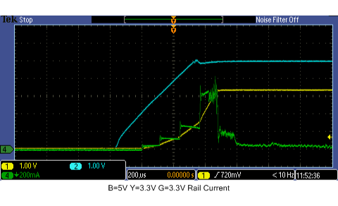

    The LM3761 starts up with a staged current limit during which the input current will be rising in steps as the circuit output starts up. The startup current limit may hit 0.6A or so even though your run-time load current is less.
    Your schottky may have a wide vf vs current spec so if this startup current is being taken via this diode it could be causing the drop. The problem may be that your input enable is derived from the supply line so as it turns on the supply voltage drops due to the startup current, which then dips below the enable threshold turning it off, allowing it to rise and enable again potentially causing an oscillation.
    A voltage detector with suitable hysteresis may prevent this rather than an RC circuit. I used a voltage monitor IC to turn the enable on when VCC reaches 3.0V. These devices are typically £0.15 so not too expensive.
    Mark

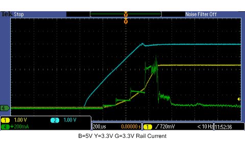

  • The screenshot below was my startup (before adding the voltage monitor). As the 5V rail rises the output is enabled but you can clearly see the staged current limit controlling the output rise.
    This was when I had Vin tied to enable but I have since changed this to use the voltage monitor.
