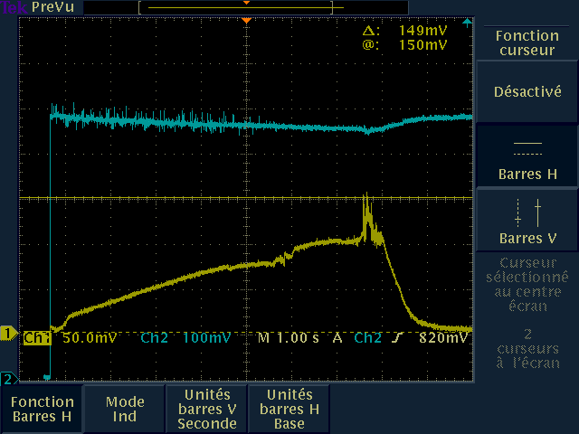

    Answers to yor questions:
    -Picture 1:
    yellow= current probe : 0.1V/A
    blue= Vin: scale/10
    -picture 2:
    yellow= Vout: scale: 1
    blue= Vin: scale: /10
    -picture 3:
    blue= Vout: scale: 1
    -Picture 4:
    blue= Vin: scale/10
    -picture 5: sorry, wrong picture: find below the right one
    -picture 6:
    blue= Vin: scale: 1

  • Hi Christophe, so each trace is measured on the evaluation board, but which IC in each instance? Are they all the original evaluation board IC (2011) or are some of the sample ICs please?
    Michael, would this be easier over the phone or Skype (so we can share screens)?
  • pictures 1,2,3 are for the EVM 1 and pictures 4.5.6 are for EVM 2

  • Thanks Chritophe.
    As stated, the two Units you refer to are the same in terms of Si-revision. We would expect all of them to behave as in the D/S sections Michael mentioned in his last post.
    Due to Units being exchanged and handled a lot, It can appear that they see damages, even if just in several parameters. As of my understanding, there is just one single Unit that shows a lower start-up current behavior.
    For TPS63060, you have to expect a current of ~3.5A during start-up, which is way to high for your current limit application.
