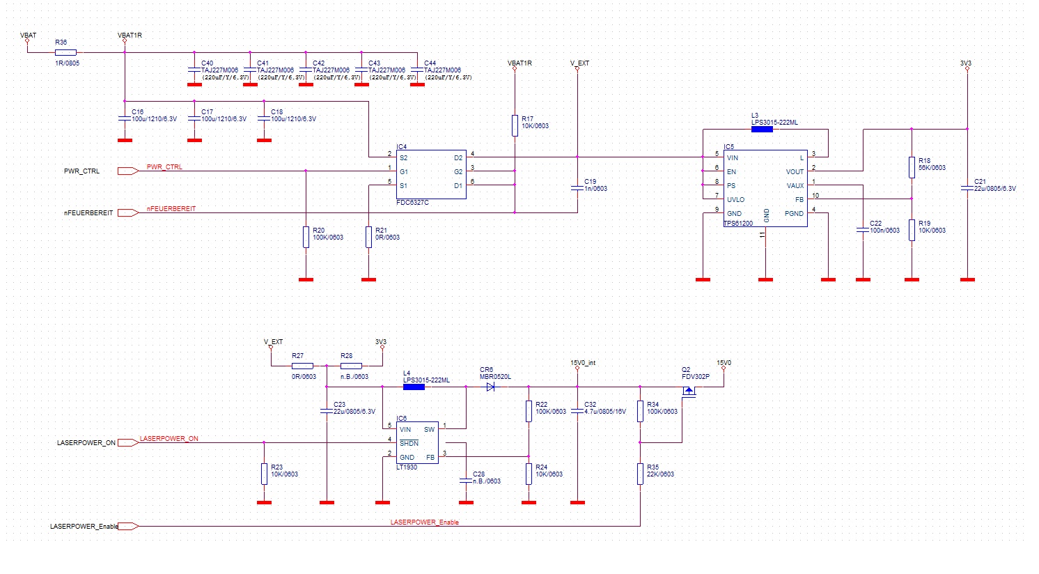

Hello everybody,
in the following design we have often problem with damaged at pin 3 of TPS61200. It gets after some uses low ohmic (3-4 Ohm) and input currents goes up to 600mA. Do somebody has idea, in which condition can it happen and what can cause it?
Thanks and best Regards,
