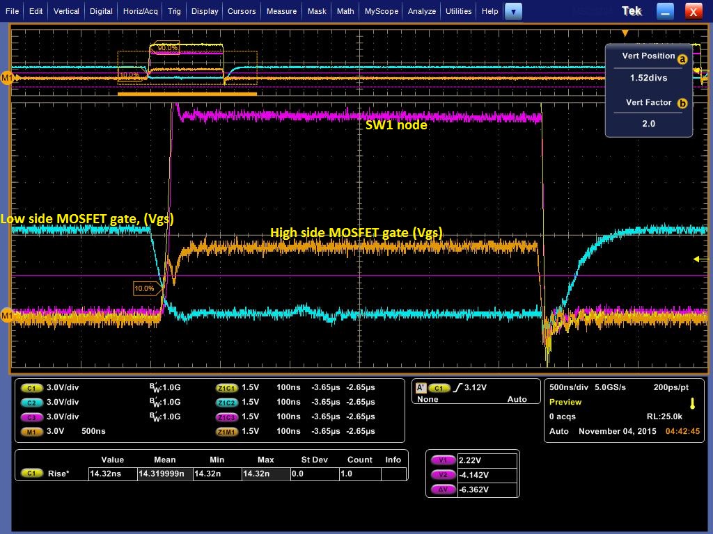

We are using TPS40140 for converting 12V to 1V8 (1.8V).
It has been observed that the MOSFET used (IRFH7914) is burning after board is powered on and is working for few days and as a result a 12V to GND short is observed.
There is gate series resistor (10 ohms) for each MOSFET.
To debug this issue , we have probed few nodes in the circuit(High side MOSFET gate to source,Low side MOSFET gate to source,SW1 node,High side MOSFET gate w.r.t ground).The schematics and waveforms are attached.
1)We are able to see an overlap of High side MOSFET gate to source and Low side MOSFET gate to source waveforms when Low side is switched OFF and High side is switched ON.Whether this will cause cross conduction and whether this is the reason for MOSFET going bad?
2)whether replacing gate resistor by 0 ohm will result in faster turn OFF of low side and may solve above issue?But this will result in faster turn on also.please suggest how to solve this issue?
3)We also observed some gate voltage(around 1V) during start up.The waveform for the same is attached.Whether this also can cause MOSFET to go bad?Whether any pull down resistor(between gate and source) for each MOSFET is required to solve this issue?
  • Schematics and Wave forms are attached here   .
    It is highly possible that the FET failure is caused by the overlap bettween HS-VGS (high side gate to source) and LS-VGS (low side gate to source).
    There should be a dead time between HS-VGS and LS-VGS to avoid short-through.
    Please change low side gate resistor to 0ohm and reduce high side gate resistor to several ohms (2 to 5 ohm)
    Qian

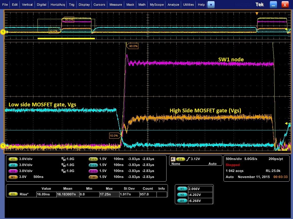

    Can you please explain why we are providing different gate resistors for High side and Low side MOSFET? What is the difference in the effect?
    The waveform for High side MOSFET with gate resistor 2.21 ohm and Low side MOSFET with 0 ohm resistor is as shown below:
    The waveform with all the gate resistors to be zero ohm is as shown below:
    Please see this and suggest further measures to be taken.
    Rasif
  • Hi Rasif,
    The HS gate resistor is to slow down HS FET turn-on, hence to reduce the voltage spike on switch node. You also can use boot resistor to slow down HS FET turn-on.
    The LS FET needs to be turn on and off quicly, therefore the LS gate resistor can be 0 ohm.
    I see there still some overlap between LS-VGS and HS-VGS when LS FET is off and HS FET is on.
    Can you check if the failure goes away after change gate resistors?
    Thansk
    Qian

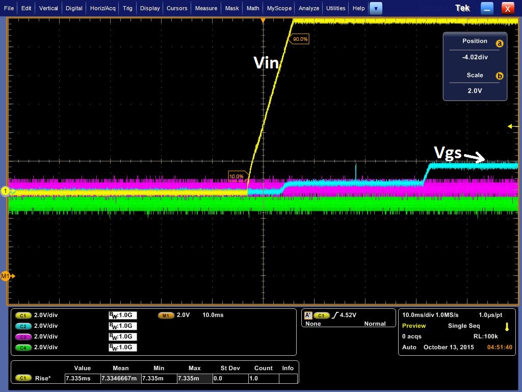

  • Hi Qian,
    Also, please note that there is a initial gate voltage of 0.5V - 1V during the startup. Is this expected or will this be another cause for the issue?
    Do we have to provide a pull-down resistor to pull this voltage to 0V ?
    Rasif
  • Hi Rasif,
    The overlap only happens when HS FET is on and LS FET is off.
    Please increase HS gate resistor (Rg) value to slow down the turn-on of HS FET, hence to reduce overlap between HS-VGS and LS-VGS. Meanwhile, add a schottky dioe Dg in parallel with Rg as below figure shows to keep HS FET being turned off quickly.
  • The figure how shottky diode Dg is placed can be found on latest TPS40422 datasheet page 19, figure 13
  • Please add a 10k resisstor between FET gate and source to see if the initial gate voltage is eliminated.

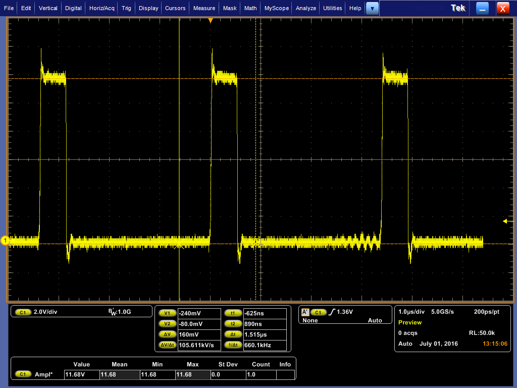

  • Hi Qian,
    The measured voltage values for pin FB is 200mV and pin Comp is 800mV in the system  with 1V8 issue.
    Whereas in working sytsem, voltage values for pin FB is 700mV and pin Comp is 2.2V
    Also the waveform for SW pin is attached and Vout voltage is 0.65V
    If FB is 0.2V, COMP should be high to make Vout regulated, but you said COMP is only 0.8V.
    Can you provide the latest schematic in pdf file?
    Qian
  • Hi Qian,
    The schematic for 1V8 is attached in here. The gate resistor values for HS Mosfets is 2.2 ohms and LS Mosfets is 0 ohms.
    /cfs-file/__key/communityserver-discussions-components-files/196/1V8.pdf
    Giridhar

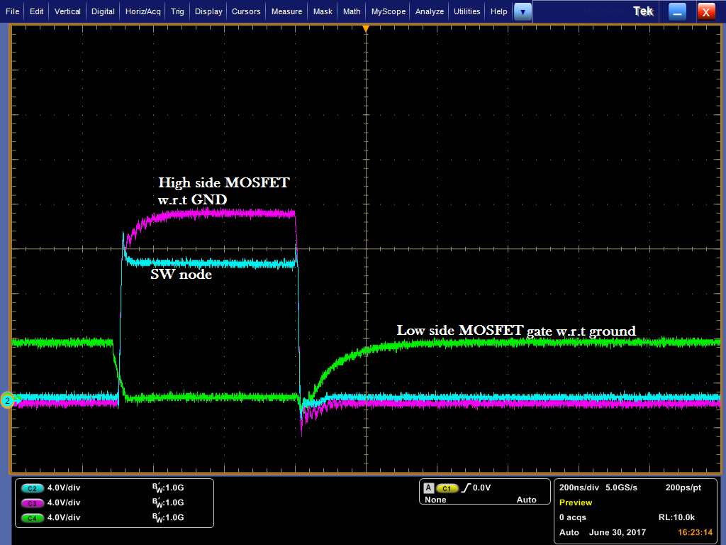

  • Hi Qian,
    We had revised the design as per your suggestion and these are the waveforms we are getting:
    1. We have used high side MOSFET gate resistor as 22.1ohms and low side MOSFET gate resistor as 10ohms, with a parallel diode respectively. Now the overlap has reduced and is very little resulting in very less cross conduction compared to previous case. Though there's switching loss due to 22.1ohm High side gate resistance, but the MOSFET can be saved.
    2. The schematics is as shown below:
    0753.1V8.pdf
    You can see we have also connected a 10K between gate and source for both High side and Low side MOSFET.
    3. The issue now is we are still observing that Q9 and Q10 (high side MOSFETS) are going bad.
    4. Can you please see the schematics and point out issues, if any. Also can a faster turn off of the Low side MOSFET cause a high dI/dT resulting in reverse recovery issues?
    5. Is the 10K resistor between gate and source fine? Is there an issue with that?
    Can you please reply on this urgently. The project is held up due to the same.
    Rasif
  • Zoomed in waveforms.
  • Hi Rasif,
    What test condition did you see the high side FETs are damaged?
    What's the failure result, drain to source short, drain to source open or other?
    Do you have a thermal camera to check the FET temperatuer?
    The 10kohm resistor between gate and source should not be related to the FET failure.
    The faster turn off of low side FET is not related to the reverse recovery of bode diode.
    Qian

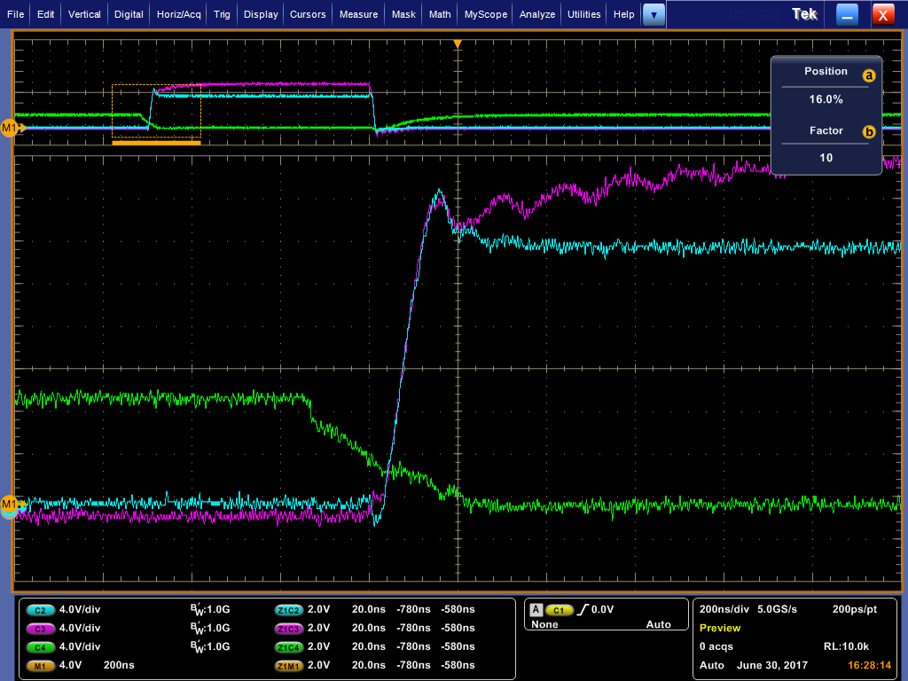

    We have powered it up under no load and very less load compared to the design. We have observed drain to source short.
    Also, earlier we the MOSFETs used to go bad after a period of operation, more than 6months. After the recent revision of schematics, the MOSFETS are going bad on power up itself.
    Yes, we have a thermal camera. We'll check on this and get you results.
    Can you please explain if there's a DEAD TIME inherent to the IC working? We saw a Anti-cross conduction block in the datasheet, can you please explain what is about?
    Rasif
  • Hi Rasif,
    There is adaptive dead time circuit inside IC.
    Your waveform shows the LDRV falling edge is slow. Can you change LDRV gate resistor to 0ohm and test again?
    Qian
  • Hi Qian,
    We had earlier attached the waveform with LDRV gate resistor as 0ohm and posted it in the thread. Can you please check it?
    Also, In the schematics, you can see a Schottky diode parallel to the LDRV gate resistor. Isn't it as good as placing a zero ohm resistor, for turn off?
    And, if there's an adaptive dead time circuit in the IC, why are we seeing an overlap between both the waveforms?
    Rasif
