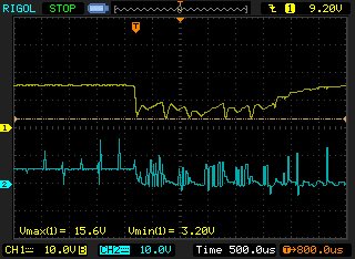

I really have nightmare with this chip, first was failing on just touch to chip or 5VDC line , that was sorted out with new silicon updates, now I have them failing on load changes. To explain I have this DC converter to supply power to Raspberry Pi , there is Hardware Watchdog Relay on RPi, if for some reason RPi stops running linux relay will cycle power on RPi to reset it, when this happens  TPS563200 Fails.
Not sure if something is wrong with my design , it is from TI Design Software as well all parts are per software.
