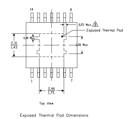

What are the correct TPS54625 Thermal Pad dimensions?
Other Parts Discussed in Thread: TPS54625, TPS54325
The TPS54625 has two pictures showing the thermal pad dimensions.  Figure 16. of the datasheet indicates a 2.46 x 2.31 mm dimension as shown below (page 15.).  The figure on the second to last page of the datasheet in the section labeled "Thermal Pad Mechanical Data" indicates that the dimensions are 2.31/1.43 x 2.46/1.75 mm (last picture show below).   Looks like the orientation of the thermal pad is in question here.  We are asking the question on behalf of our customer.  Please let us know which is the correct orientation.  Thank you.
