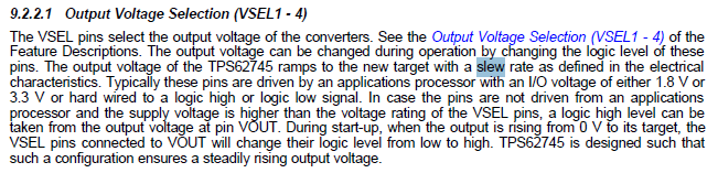

I checked the datasheet for the TPS62745 to see what the slew rate is for Vout changes and found the following comment:
However I could not find slew rate in the electrical characteristics. Can I get this info?
