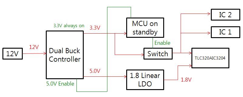

  • Hello John,
    I need 3.3V and 1.8V to power my ICs
    And rough diagram looks like below and the diagram is based on TPS51225.
    If there is a dual controller with 3.3V and 1.8V out, that should be the best fit.
    I need at least 200mA of current for 3.3V and out of 200mA, 150mA is for the TLV320AIC3204.
    for 1.8V, 50mA should be more than enough.
    Could you give me an advice for the most cost effective dual buck controller with an output of 200mA?
    Thank You
  • I'm a little confused.   Do you just need 3.3V and 1.8V, or do you need 5 V as well?
