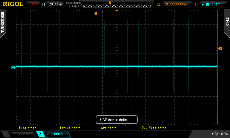

    With the automotive version of TPS63000 on the board, the quiescent current is 50uA (normal) and the riplle has a period time of approx 40 mSec.
    The signal on the coil is synchronized to this period time.
    (see picture, the blue peaks are hard to see, but they are there, nicely synchronized)
    When I load the board with a capacitor, the unit draws much more , like 180 uA current. and I can see that the ripple is gone, and the buck is no longer synchronized. It it switching faster.. That's why the quiescentcurrent gets higher I think.
    Then I replaced the unit for a rev c unit. I noticed also 50 uA quiecsent current, but the frequency of the ripple is much lower! see photo. (the period is now like 150 ms.
    When I load it with the same capacitor, the quiescent current increases a little, like <10uA. so a big difference!
    Also the signal on the coil is not so "busy" like the other unit.

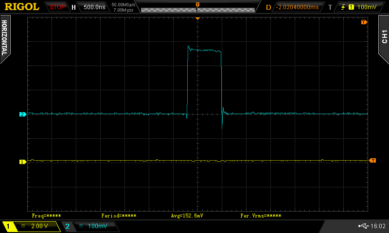

    Also I mentioned, when I zoom into this coil signal, there are differences between the 2 units.
    unit automotive: 1 single puls (see photo)
    unit rev: c: multiple pulse.
    So, I noticed a few differences between the two units (frequency of ripple during quiecsent, and the pulse on the coil)
