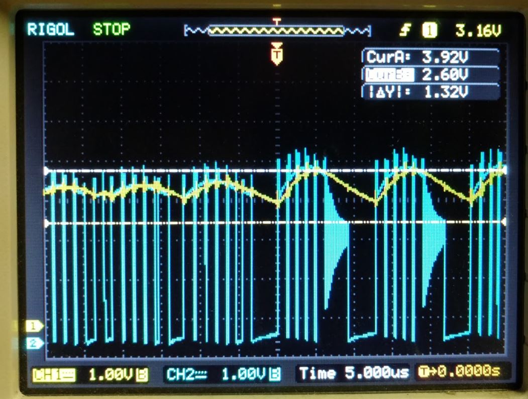

When i connect my load, the output drops to ~3V and the waveform is a sawtooth (approx 1.3V pk/pk). The yellow waveform is the "5V" output AC coupled. The blue scope is not relevant (it's the 3.3V rail).

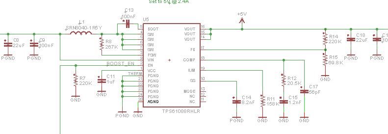

This circuit was designed with the webbench wizard. Here it is:

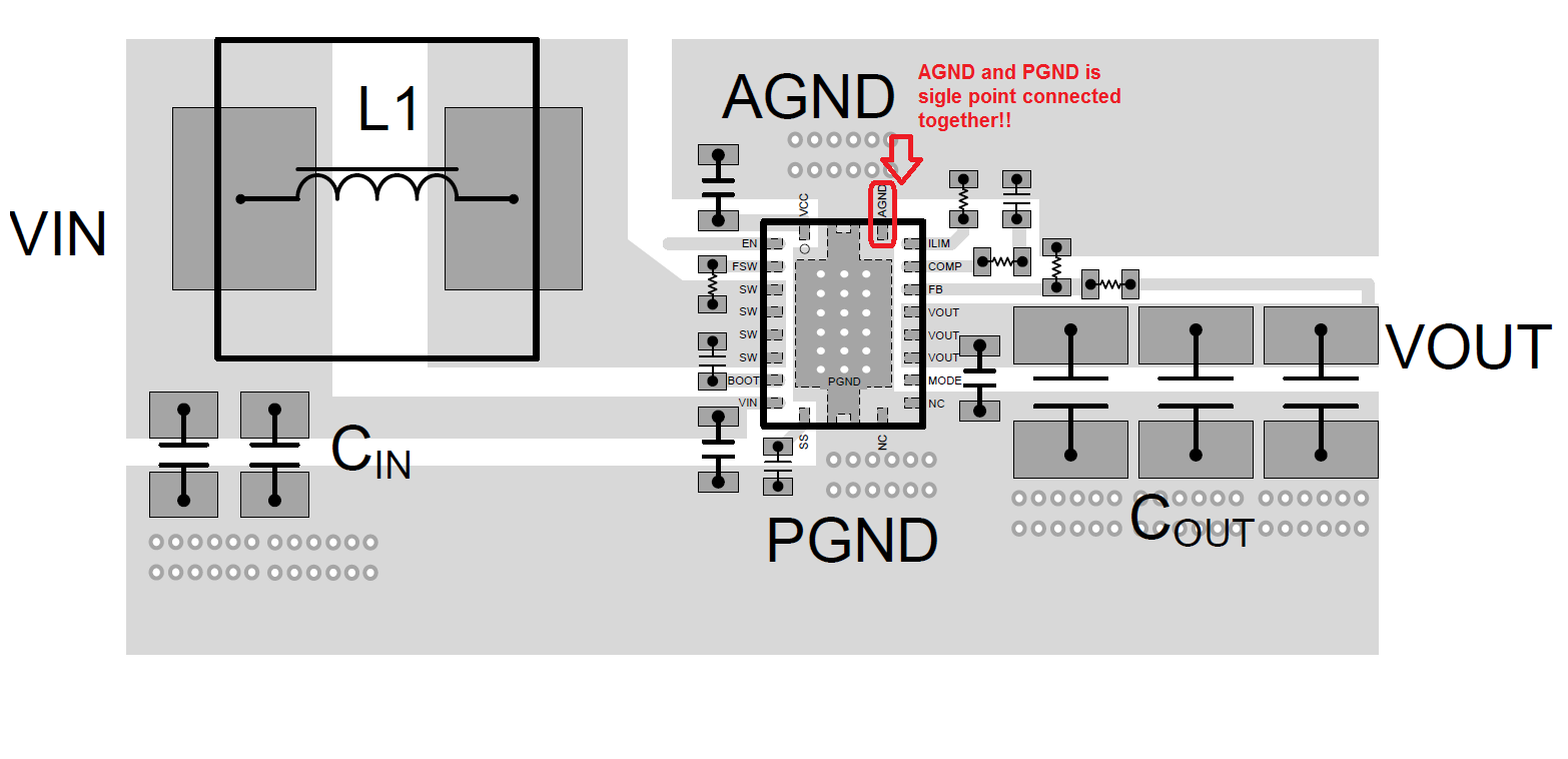

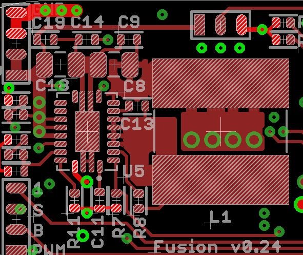

The layout isn't terrible
The inductor is rated for 7A, current limit set to be between 4-5A and the parts aren't getting warm as far as I can tell.
Probing the SW pins (4-7) reveals the following waveform:
zoomed out (yellow "5V" rail and blue is the SW pins)
It looks like the IC stops switching when SW reaches ~5.25V.

I suspect there isn't enough output capacitance and/or there's something wrong with my compensation network values.
Before making this post I increased the input capacitance to 44uF and output capacitance to 88uF. This didn't fix the issue but it made some changes to the circuit's behavior:

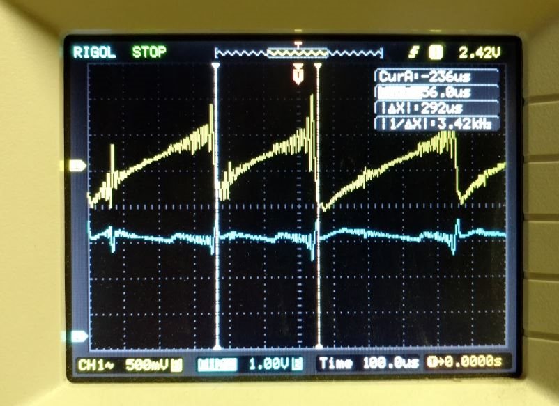

Edit: I experimented with different values for the compensation network but the changes I was making didn't make a very noticeable difference. I probed COMP pin and noticed that the signal would periodically drop to 0V momentarily before shooting back up to a nominal 1.7V. Looking at the block diagram, the only component that could pull the COMP node to ground would be the error amplifier. The inputs to the error amplifier is soft start and the feedback pins. I don't think the soft start circuitry is affecting anything and the feedback node never reaches 1.2V, so I doubt it's responsible for pulling COMP node to 0V. Any thoughts on what else could make this node drop to 0V?
Edit: I reduced the load to 0.8A and I'm getting a very well behaved circuit when Vin = 3.2V - 4.2V. The sawtooth comes back when lower the input voltage below 3.2V. Again, this makes me think the problem is the device is hitting some internal current limit and the part's deadtime before restarting the switching cycle is too long. I'm looking into this now.
Edit: Curious what would happen... I increased the Ilim resistor to allow for 11A of current. I think this made the circuit worse... On the other hand, I decreased the current limit to 6.3A and it also didn't help or change much.
Edit: here is a scope capture of the output (yellow waveform) and the COMP node (blue). Notice how something is pulling this low (I still assume it's the error amplifier doing this, but why?)
Edit: I tried increasing the capacitance of the RC filter on the COMP pin from 1.2nF up to 14nF and there was no difference in behavior. I also tried an RC combination of 6K and 4.7nF and there was no difference in behavior.
