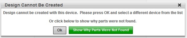

I'm Alber as an FAE in Arrow Korea
My customer try to get a optimized schematic using TPS65400, but there was an error message.

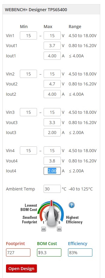

Following is their their wanted in/out spec.
Vin_min : 15V
Vin_max : 15V
Vout1 : 3.7V / 4A
Vout2 : 4.7V / 4A
Vout3 : 3.3V / 2A
Vout4 : 3.8V / 2A

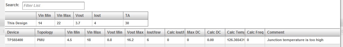

Why there was occurred error message?
Can they use these output spec at TPS65400?
How to solve this WebBench Error?

  • Hi, Alber
    it is the ambient temperature limit the this design, please change the ambient temperature to 0 degreeC and take a try.
    so the SW1~4 work max loading at the same time, the IC would trigger OTP.
