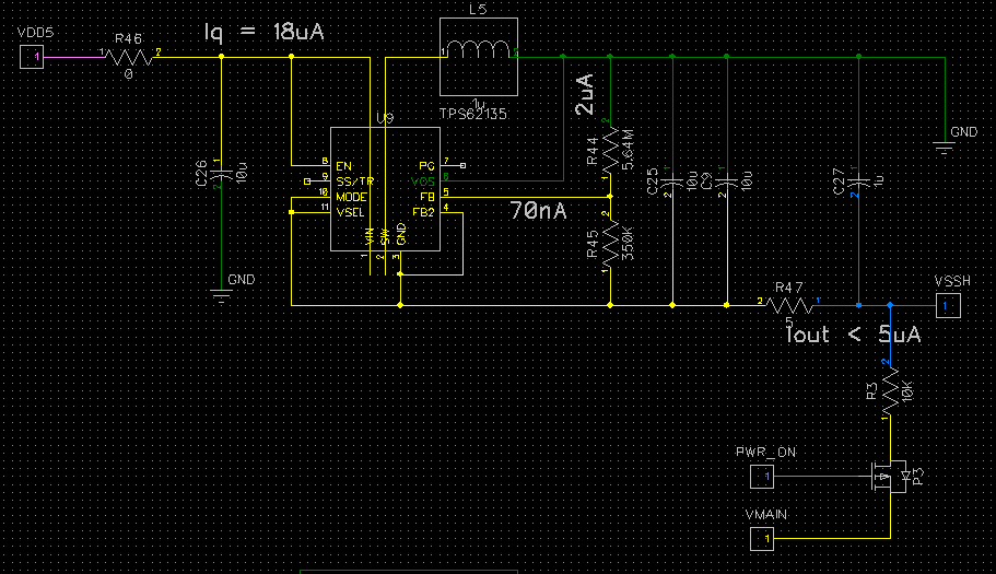

    We got a test board back, and are trying the inverting boost with tps62135.  The schematic is attached.
    The inductor is Murata LQH3NP series 1uH part number LQH3NPN1R0NJ0L.
    Resistors are 0603 thin film. R1 = 5.64M and R2 = 350K, for a 2uF feedback current cost (accuracy is not critical).
    Output caps are parallel 0805 10uF with minimum 20V+ rating.
    Input cap is a standard 0603 X7R good for input voltage of 5V+
    Output PMOS discharge switch for shutdown is tied to Vin, so that it is off and not loading for this test.
    The output load is a 2K resistor to ground drawing a max of 6mA from output at  -12V

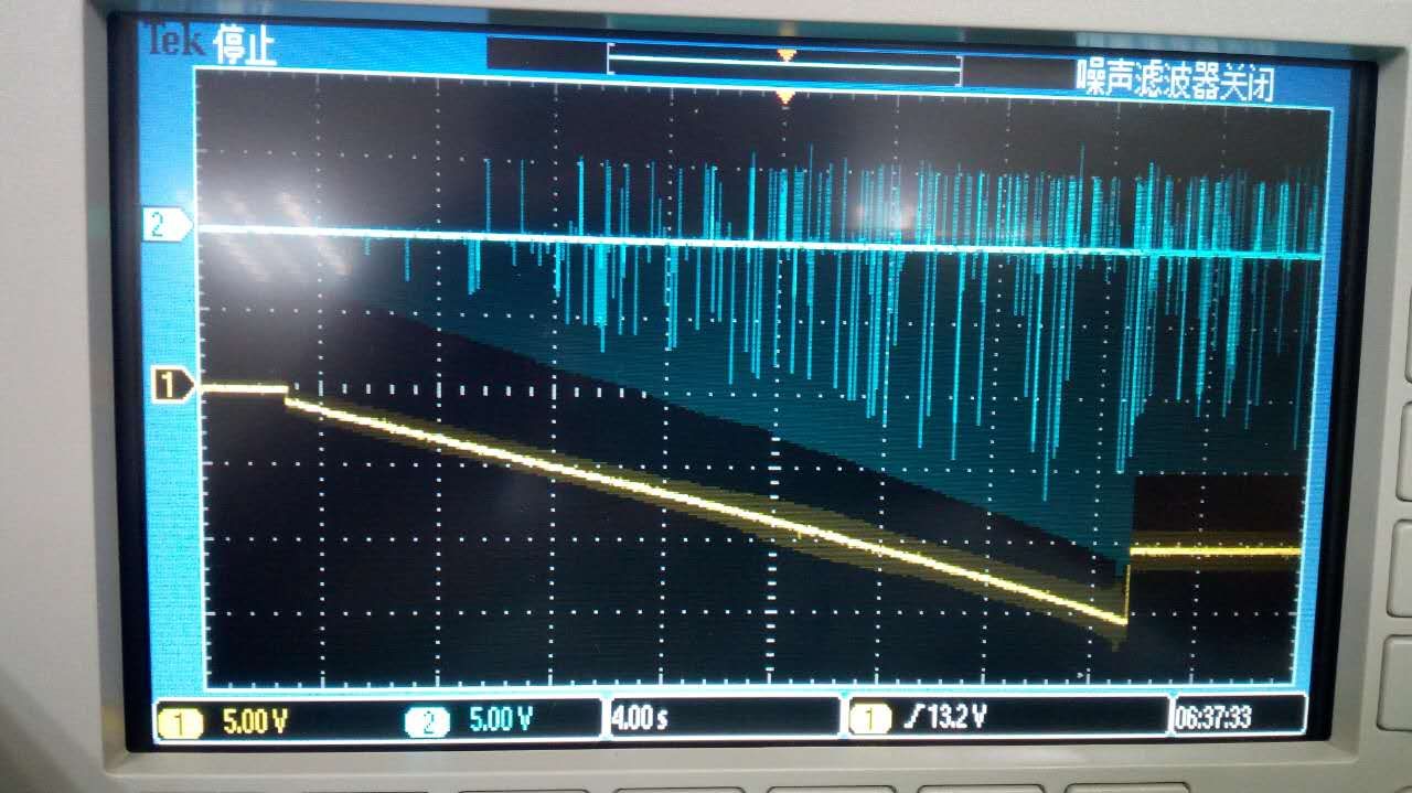

    The issue on immediate functionality is that, this circuit take 30 seconds to come up to a stable point (~-10V) and the end point transition has a significant overshot as shown in the attached waveform snapshot.

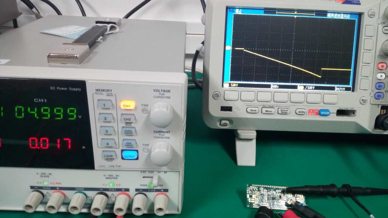

  • Hello Chris,
    Things did not improve, here are some observations:
    Testing the implementation at 5V input did not improve the outcome.  The photo shows the supply at input and output trace over about 30s.
    The SW node waveform reveals long switching interval. The interval is longest at initial startup and becomes shorter and shorter as the output is coming up.
    The initial startup SW switching interval is shown here with a 1nF SS: ~680us
    The initial startup SW switching interval is shown here with a 10nF SS: ~410us
    In a steady state condition after startup, the switching interval becomes about 20us
    The input waveform is pretty stable driven by a power supply at 5V.  The average input current was at 17mA for a 2.2Kohm (~5mA) load at output at steady state.

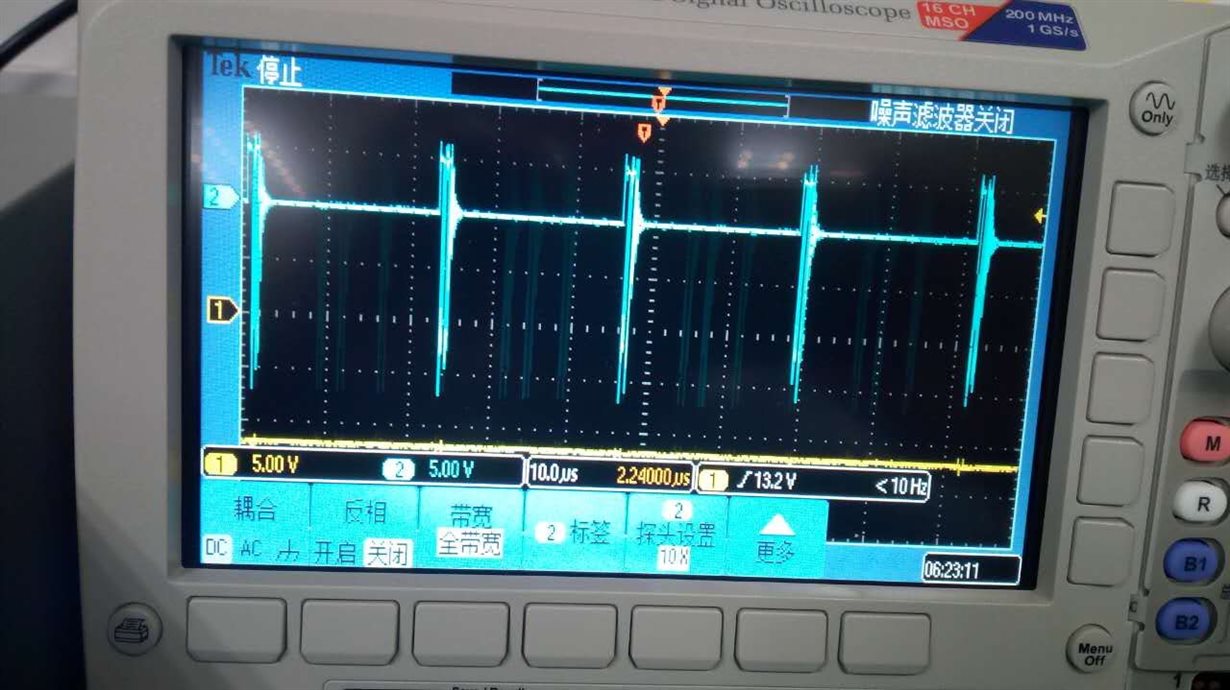

    In addition here is a zoom-in on a switching pulse at SW node.

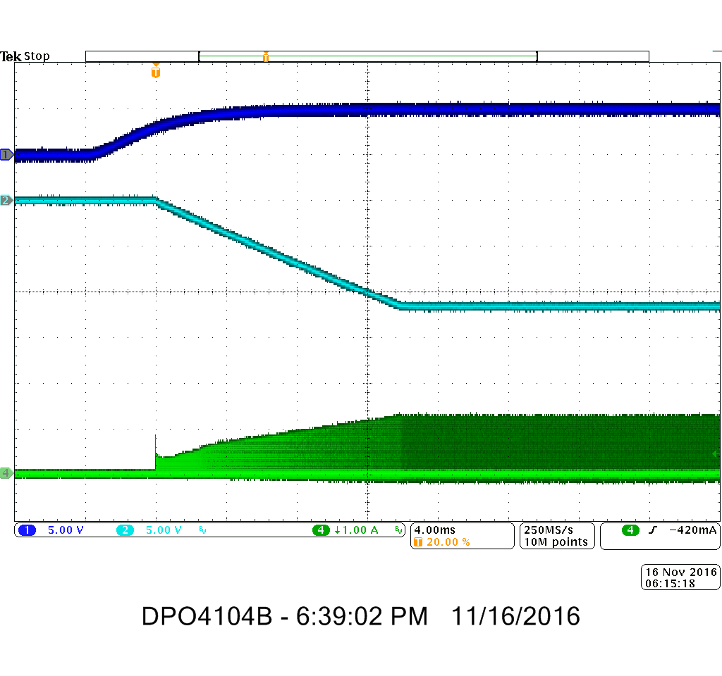

    i did a startup measurement on the TPS62135 with following conditions:
    Vin: 5V,
    Vout:-12V (same resistors as above)
    Load: 2k
    Cout: 22uF
    Cff: 50nF
    Blue: Vin, Light Blue: Vout   Green: Icoil
    With this conditions i couldn't see any issues. Could you generate the same plot?
    Michael
  • Michael, your results are encouraging, thanks for the support. Your traces looks good and the part switches nicely. Just to make sure the comparison is strict.
    Can you confirm the connections in your test are exactly the same as the given schematic in the earlier post, MINUS the Cff (I assume it is Css for softstart)? And if Cff is for soft start, could you confirm with the SS pin open, 1nF and/or 10nF? Really appreciated. Also is your version of the IC the straight up tps62135 or the tps62135(1) version?
    Putting some expectation on this on going communication: The engineer who is hands-on with this block now is at his night time, I am designing and facilitating around the clock.
  • Michael will have to reply back tomorrow on the specific IC version he used, but otherwise his test setup matched yours. Yes, Cff should be Css. The 14 msec SS time is right where it should be for a 50 nF cap.

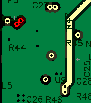

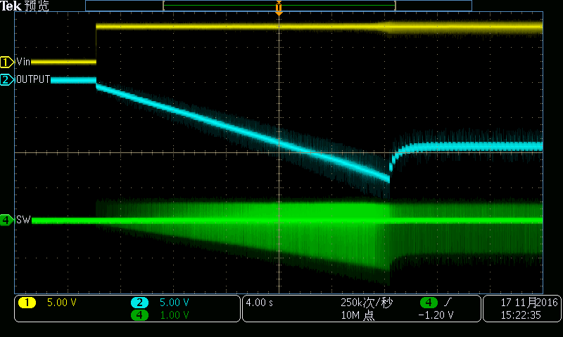

    To help speed this up, could you post a similar waveform will all traces on one scope waveform? And the PCB layout and BOM for the passives around the IC would be good to check as well.

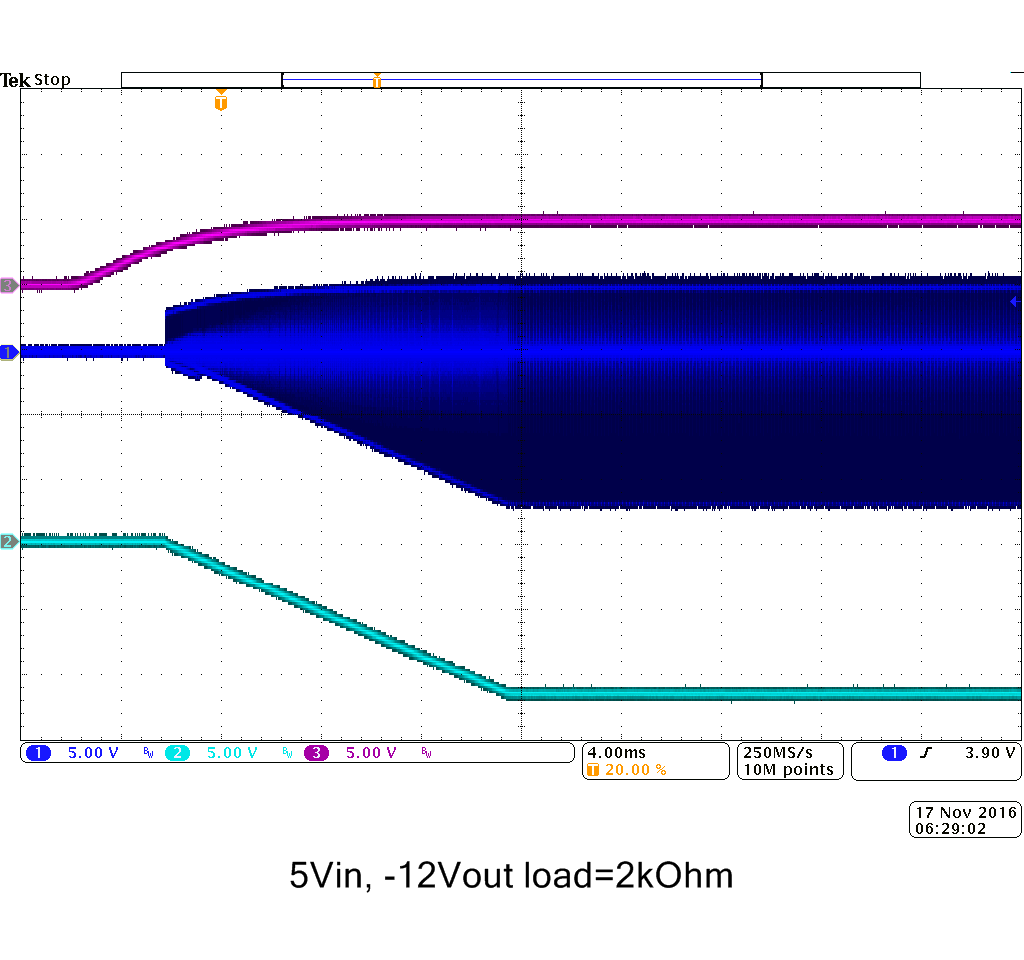

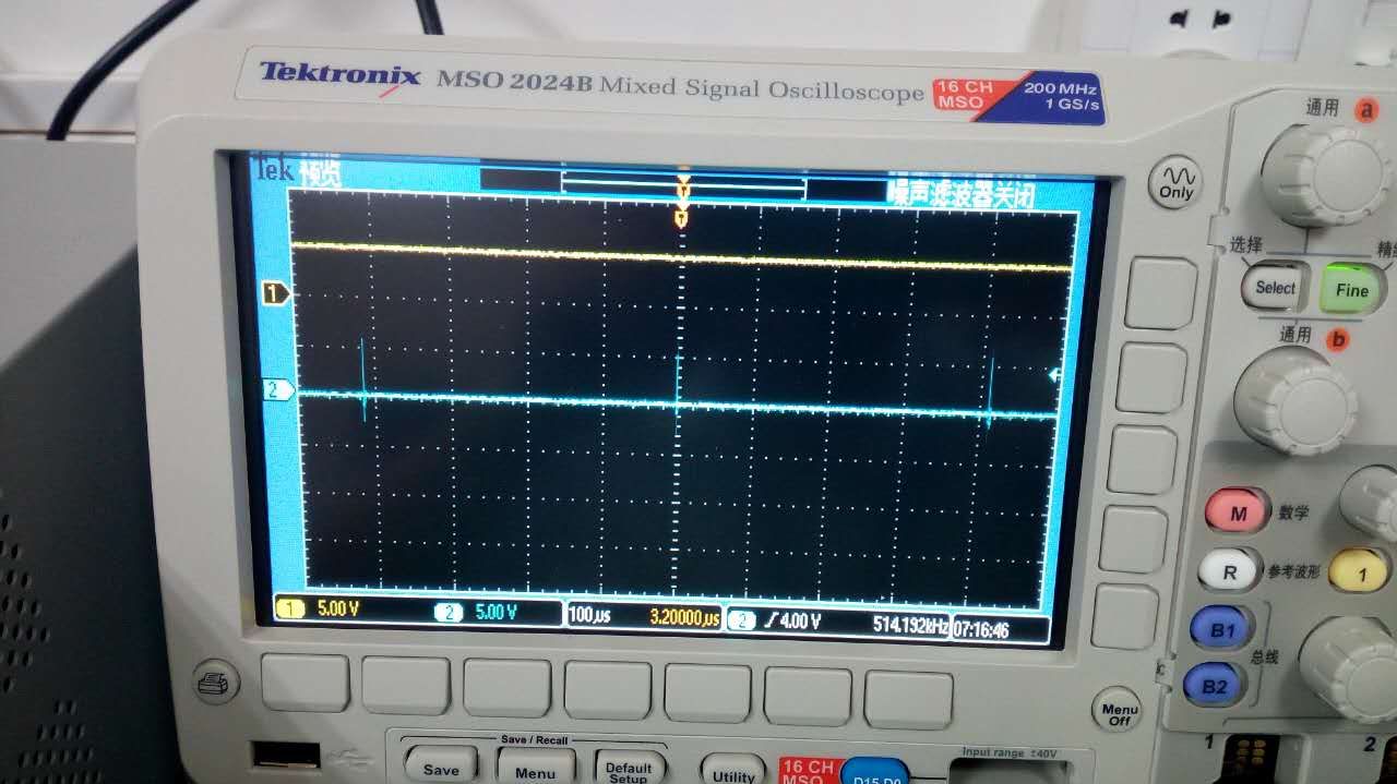

  • Hello Chris,
    Here is what I have for now.  I will populate and update once I have better information
    Here is a waveform trace of the SW and output at comparable scale minus input for now.
    Again, here is the schematic

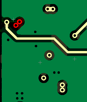

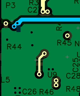

    Here are snapshots of the layout, dark green is ground
    Top Layer
    Inner Layer 1
    Inner Layer 2
    Bottom Layer

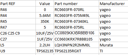

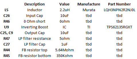

    Immediate BOM information

  • Thanks for sharing. What caps did you install on these PCBs that you are testing?
    You might try installing a SS cap of 10 nF or so. One of your previous posts said that you did this, but did it speed up the SS to a normal value?
    Could you try lower impedance FB resistors? i.e. 56.4k and 3.5k? This would help rule out any external noise influence.
    As well, look at Vin at the IC (on C26) during startup. That looks to be a narrow trace from elsewhere to this circuit, so there may be quite some voltage drop.

  • We don't have a current probe for the scope.  We can only obtain voltage trace right now. Let me know the best way to present this information.  The engineer still had no luck getting it to work as intended just now. He made another board with a 47nF CSS,mimicking Michael's test, the behavior is still the same taking 30s to come up.  He is assembling information per the above list, but in general, the caps are all rated at 25V X7R or X5Rs.  He did try lower value feedback resistors though yielding the same result.  The trace you pointed out is not long, pretty much ends at the edge of the capture, it should be 0.4mm if not any bigger, I can widen that in the coming revs, but the important thing is that, the test is done by soldering wire directly at the input cap.  Thanks again and let's figure this out.  Best.

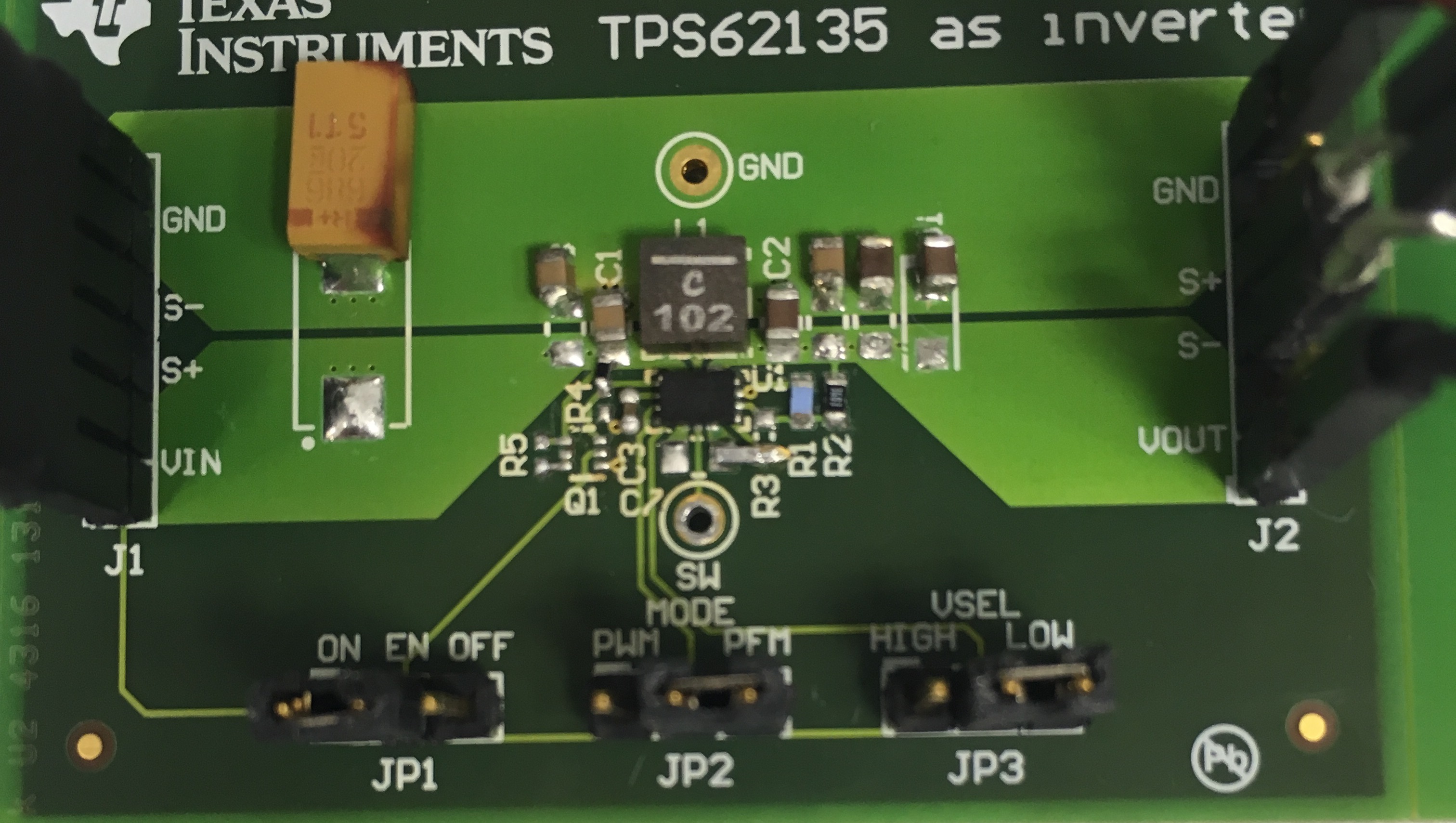

    Our engineer would like to get a close up picture of Michaels setup just to compare and see anything is wrong with our board.  Thanks again.

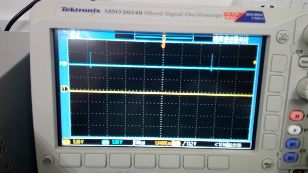

  • Hello Chris and Michael,
    Made another board, same un-functional behavior, setup exactly like Michaels with a 47nF Css.  Engineer wants to have a close up on Michaels board.
    Here is the updated scope capture
    Here is the updated BOM
    below a picture of the board which i used for the measurement.
    I tried to use same values and same connections as on your schematic. The device is starting as shown below.
    Which inductor do you use? on the schematic is a 1uH but on your BOM is a 2.2uH
    Michael
  • The current board has 2.2uH on it the Isat is a little over 1A, I wonder whether that has an issue.
  • Depending on the softstart time, the inductor current can get much higher during startup.
    I would recommend to use a 1uH with higher saturation current.

  • Yes,
    We made two board, tried three ICs, the latest one has a softstart Css=47n. The behavior is the same. Why 1uH instead of 10uH, meaning why go smaller? I see the Coilcraft inductors (the one you use) are very good I am looking into the XFL series, they handle up to 5A, wow.
  • Any chance it is hitting the current limit? HICCUP?
  • From your waveforms, I don't think so. But you could zoom in on some switching pulses. If you see 512 of them in a row, this is hiccup current limit.
    It might be worth trying a higher saturation current inductor. Generally, in a given package size, saturation current goes up with reduced inductance. The 1 uH in your Murata family has a little bit higher Isat rating. If you are able, I would find a >3A Isat coil to test.
    Could you remove SW and add FB and SS to your last waveform?
