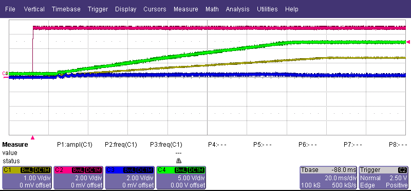

  • Garret,
    There is no diode, just two 1k resistors.
    All traces below are BW limited to 20MHz.
    SS (yellow), VCC (magenta), COMP (blue) and VOUT (green):
    Hmmm. It seems that COMP goes to 5V and stays there for some reason.
    SS (yellow), VCC (magenta), VIN (blue), VOUT (green):
    And here are the same waveforms for a normal start-up, with no pre-biasing:
    Thanks!
    Bart

  • Garret,
    I added the diode. It made no difference; the waveforms did not change.
    Why does the diode matter? Without it, the pre-biasing voltage source will sink (12V-5V)/1k=7mA, and my power supply can handle 8 amps.
    At a pre-bias voltage of less than 1.5V or more than 3.5V the power supply starts fine, diode or not.
    I have just noticed something interesting. With pre-bias of 3V, I get the "bad" set of waveforms first, and then the "good" one after a delay of approximately one second. SS (yellow), VCC (magenta), COMP (blue) and VOUT (green):
    Also, in your post, is there something missing after "the output voltage of the diode is..."?
    Thanks!
    Bart

  • Garrett,
    (It seems that I have been misspelling your name - sorry!)
    I removed C28 and observed no improvement.
    There is an external undervoltage protection that will prevent the EN signal from bein asserted below 11.5V - that's why I started my testing at 12V.
    With C28 removed, the last waveforms changed somewhat (and I am not sure is there is a cause and effect relationship here). Again, SS (yellow), VCC (magenta), COMP (blue) and VOUT (green):
    Note that VCC does not drop - actually, it rises.
    And here is the same waveform, zoomed in. You requested a closer view of the moment when I "turn off the converter and the output voltage rises". Just to clarify - I do *not* turn it off. It does it all by itself. I verified that the EN signal stays high after the initial enable.
    Yes, I use EN to turn the IC on. The DC input appears first, and the EN signal is asserted a couple of seconds later.
    The "spontaneous restart" seems to only happen below 25V DCIN. Other than that, I do not see any dependence on input voltage.
    Thanks!
    Bart
