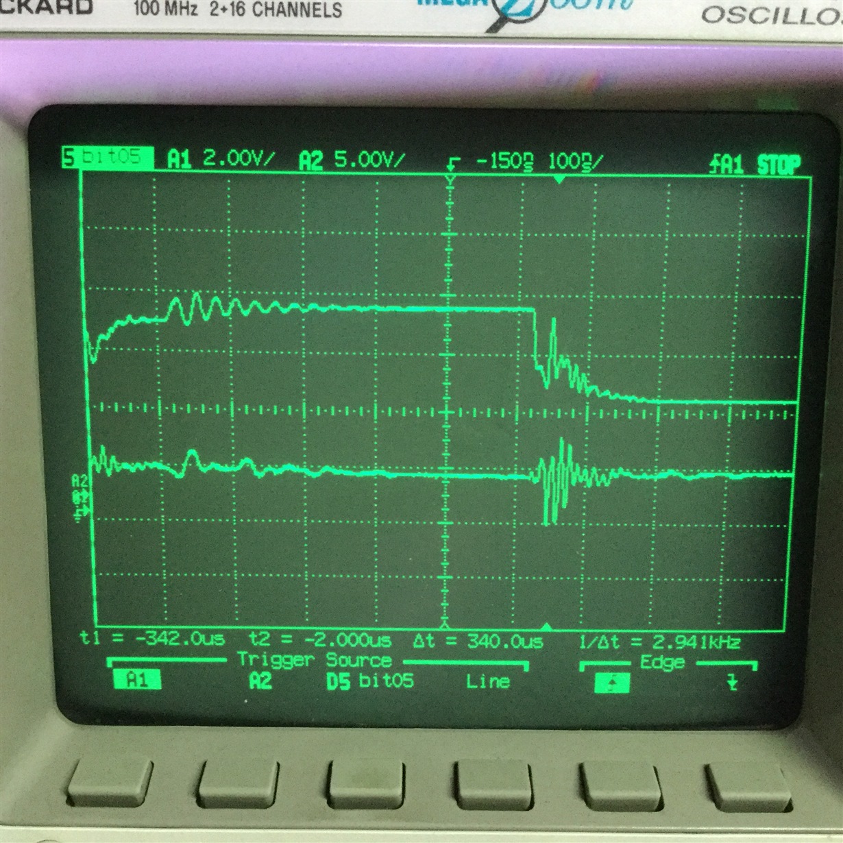

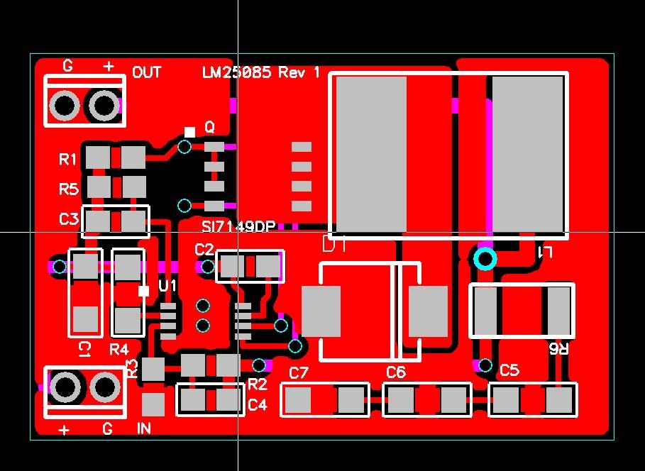

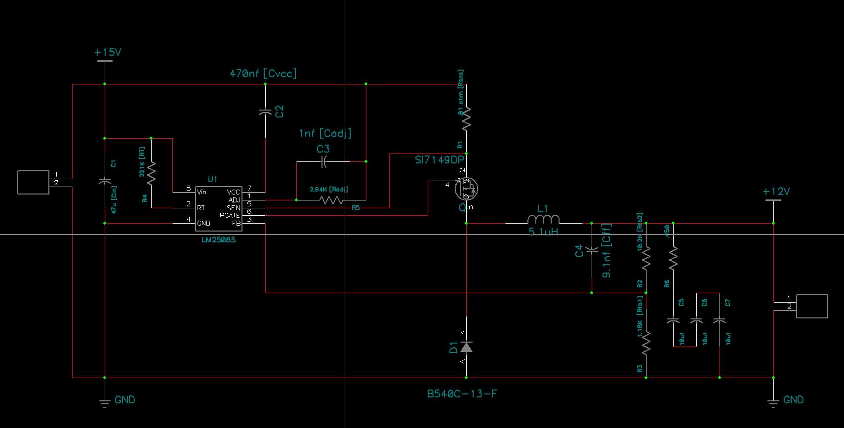

I used Webench to setup a buck converter with Vin=12, Vout 12 @ 7A. I have attached schematic and layout. With no load the output is 12.3v but when I put a load on it jumps to 13.4v and increases as I put more load.
