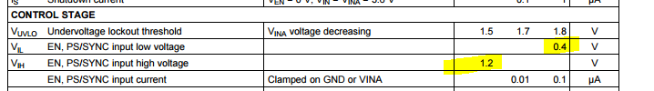

  • The EN tolerates voltages  between GND and VINA. As you can see in the datasheet of this device:
    The min voltage to be applied to enable the device and the maximum voltage where the device stays disabled is specified. Is this what you are looking for?

    Thanks for the quick response. We just need a confirmation that the EN pin won't be damaged when it's not pulled to VINA or GND, but is set between VINA and GND. Judging by the given VIL and VIH, it seems that this is not a CMOS input, but rather some sort of TTL. Are we correct?
    We need an ad hoc solution for several already populated boards. The converter needs to start up only when input voltage is above 3.5V (100k - 51k divider produces 1.18V on EN when VIN is 3.5). We understand that VIL and VIH are not defined between 0.4 V and 1.2 V and it is not a problem if some boards start sooner than 3.5V. The only question is whether it's safe to have the EN input constantly at around 1.2V - 1.3V?

  • According to the datasheet , If EN pin voltage is equal to 1.2V and above, the device stays enables. I don't see any issue to keep the enable pin to 1.2V or 1.3V.

    The 800mV could potentially vary with temperature and IC process variations. Unfortunately this is an old device, at that time , the functionality was checked through a go/no-go test, so there is no EN threshold level from production that can be provided.
    I don't think keeping the EN between 0. 75V and 0.85V is suitable solution for this issue. We can not guarantee those values, and I expect the device to not even get enabled at 0.75V.

  • The EN input is a digital CMOS. As you measured, EN high level threshold is around 800mV. There may be devices that gets enabled at 750mV but it needs to be tested individually, but there may also be devices that get enabled at 850mV. As you need a work around for your application I would try to keep it higher than 850mV. Is it possible to achieve this by adjusting the resistive divider?
