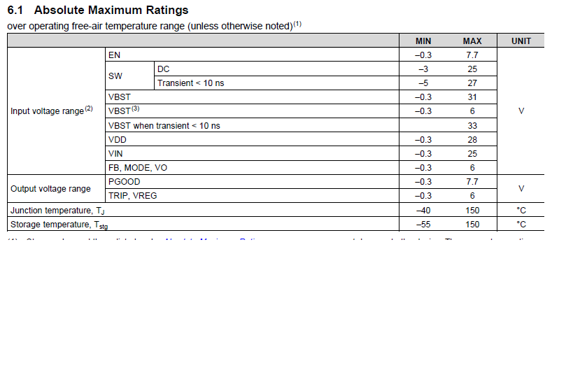

Is internal MOS parameters of TPS548A20 30V voltage? Due to customer concern VIN maybe have over 30V spike voltage so request the MOS spec. Thank you.
