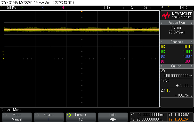

I have a problem with the negative output. Attached is the schematic (U79) and some pictures from the scope.
The scope results are with R2 = 100K and R4 = 100K as in the schematic.
Before that, by mistake, R2 was 75K giving a 18V at VPOS. So I replace it to the current value.
Is there a problem in the chip itself ?
Noam

  • Hello Noam,
    Is it possible that you mixed the measurements of VREF and FBN? FBN should be around 0V and VREF should be at 1.213V.
    In your schematic PSN and PSP are connected to VIN, so you allow the device to go in power save mode. Although the ripple seems to be extremely high with more than 5V, this could be a combination of GND shift and PSN mode. Please check out if the problem is gone when connecting PSN to GND.
    I mention GND shift, because especially the connections of the components connected from CN, CP, FBN and FBP to AGND is important on this component. AGND needs to be a very clean GND directly connected to the power pad to make sure the IC is able to regulate properly. Such a high ripple on VNEG might be the result of problems with AGND.

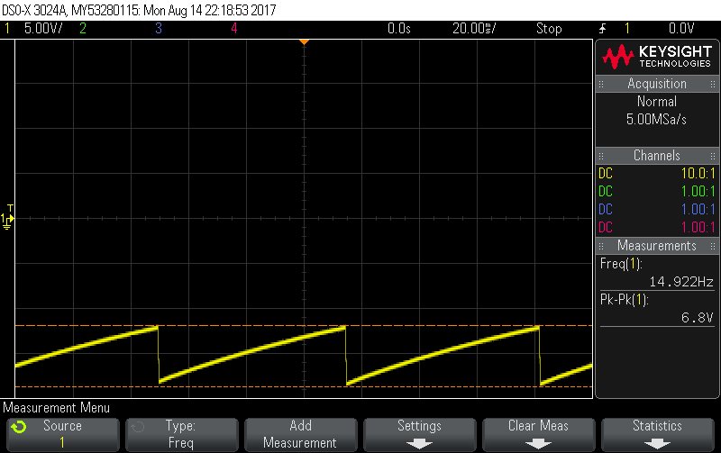

  • Brigitte Hi,
    It is a ceramic capacitor and not a Tantalum.
    Before disabling the power save mode I change R4 to give a -15V i.e. 80.5KOhm.
    Now the power is stable but on ~-18V.
    This is what I see at the inductor L8.
    Noam
  • Brigitte Hi,
    I disabled the power save mode for both and replace R4 to be 100K as before.
    Still got the same results.
    This is what I see on L8.
    Noam

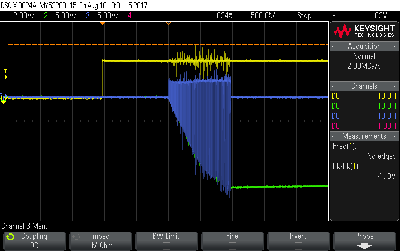

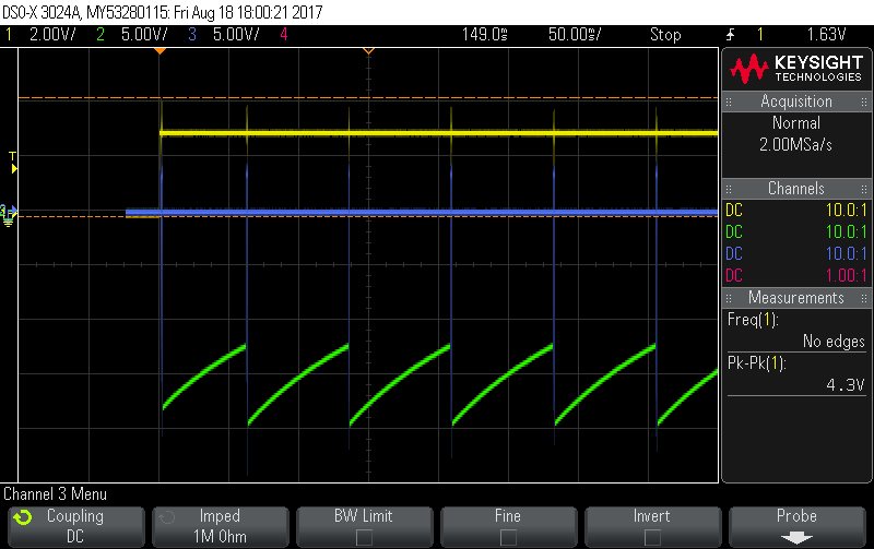

  • Brigitte Hi,
    I added some snap shots from the Scope, the following are the behavior after Enable and disable.
    Enable
    Enable Zoomed
    Disable
    Any idea why the VNEG behave in save mode although I disabled it?
    Again this is very urgent and I start loosing hope.
    BR
    Noam
  • Hello Noam,
    Not sure if I got this right from the scope plots. So you see the same increased voltage ripple on VNEG in both cases? The last scope plot with 'disable' looks like it shutsdown completely for any reason (green line is discharging to gnd). Why is that?
    What you can try is to add a 50k or 100k resistor in series with the feedforward cap C349, hereby you will damp the noise coupled into VREF.
    Best Regards.
    Ilona
  • Ilona Hi,
    I disabled the power save mode and got the same results as if it was enabled. Now I am always disabling the power save mode.
    in the last pictures: Yellow = ENN, Green = VNEG, Blue = OUTN.
    The disabled picture is for disabling the negative output ENN.
    I will try the series resistor on Sunday.
    Do you have an idea why the negative output go down to ~-18V and then back to the configured value ~-12V? What do you think is wrong with the inverting converter control?
    Do you think it is noise on the VREF? As you can see the enable signal (Yellow) has a lot of noise when the switcher is working, can it cause problems?
