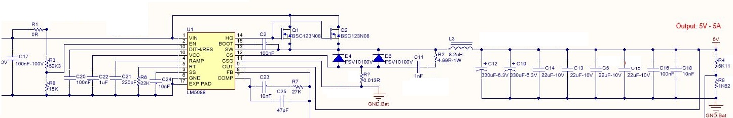

LM5088: Output is not constant when there is no load.
Part Number: LM5088
Hi ,
I am develop an LM5088 application.  Input voltage is 7-60Vdc.  Output is 5V 5A. The problem is; When there is no load, output voltage continuously changes in 3-4V range. Also, I hear the coil voice.
I  am using 8.2uH coil and  double N-FET BSC123N08 . fw=275Khz. I saw suggestions about Cvcc and Cboot. I decreased/increased  the capasitor values. There is a change, but  when Vcc:1uF and Vboot: 100n with load,Vinmin=6V, when i make a change,Vinmin=7.3V with load.
What can i do?
